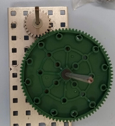

Yeah, there’s no gear ratio that can take you from 200 to 400 rpm. I’d recommend counting the teeth and calculating the ratio that way.
There are 24 tooth pinion gears now.
true, but they’re somewhat impractical because they don’t line up on the .5" intervals with the other gears.

You could use 24 tooth gears to 48 tooth gears.
That is true, 2:1 is not possible (edit: with 12t and 24t). I was able to get 5:2 and 7:2 to mesh in a rough mock up. Not sure if putting them in bearing flats would force them out of mesh.
These are only available from vexplorer kits or from iq gears, and neither of these are vrc legal.
I’m pretty sure they’re coming in the EXP kits, and those are legal.
