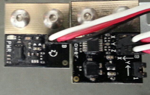

A little sensor action. [ATTACH]8445[/ATTACH]
SBD’s starting strong AND early! Texas is going to be a lot of fun this year:D…
The question is now whether those are speed gears or turbos?:stuck_out_tongue:
With a great sensor package usually follows great autonomous. You can be sure I’ll be watching the summer games.
PS. I love the plastic screws, where do you order the from?:smiley:
Fancy screws. :smiley:
One thing I find interesting is the way your base seems rather open on the inside (unless things have been removed) and also that it is a rather square base, not a U or H shape like is most common.
It also seems like, from the placement of things, that you use a battery extension, or the battery is under the Cortex. Or you don’t use batteries. :wink:
I’m really liking the use of a cut out for your ultrasonic sensor fitting it. Although still… poor cut out 5-wide :frowning: Those screws are awesome though. Looks like you won’t have any issues with screw heads getting rounded out.

Thanks Maxx. The motors are geared for speed @ 160 rpm. With 2.75" wheels and an X drive we effectively have what would be a 1:1.56 ratio with 4" wheels on a standard tank drive.
The screws are hardened steel, my dad had a bunch of them from a project he was tinkering with so I used them in places where I wanted to really be able to tighten the screws down hard. The VEX screws are the best bang for the buck when you compare the cost to allen cap screws, but since they were there for the taking I made good use of them.
Our battery goes under the Cortex. We are using an 8 sided base that measures 16.5" side to side and front to back, and 20" diagonally. The diagonal measurement allows us to turn 180 degrees between the Autoloader and the Skyrise base without having to move sideways or backwards. An 18" square base would require moving out from in between the wall and the Skyrise base resulting in lost time in motion.
We are actually using 9 motors, one was not plugged in when I took the picture. Yes, the labels are for which motor i.e. LUL is left upper lift motor.
