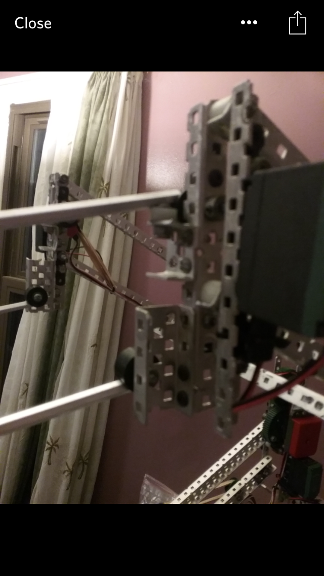

4270C Bot so Far. Thoughts?
much of it had to be unziptied for the lift post to be moved, but even then, we probably could do a better wiring job.
As you can see the bottom bar is offset (moved forward) to allow it to go all the way to vertical. This will result in more height for the same amount of weight in c channel. Side note: you do not have to offset this far. Just using the opposite sides of a regular c channel will suffice. Also, it is rarely a good idea to use 5 wides
In addition to the bot, our coding team has been working hard on the program. Any thoughts?

Are your LEDs displaying the cone height in binary? I thought that was my own original idea! :stuck_out_tongue:
Yeah. I told Ryan not to waste his time because I can’t read binary fast enough for it to be useful in match, but he did it anyways.
How is the sound file that plays the # of cones working out? Are you able to hear it in mid-match since competitions are usually noisy?
If you turn up those speakers, they get pretty loud.
OK we don’t have one, do you think it’s worth the cost? Do you think it actually is useful in a match? @MasterCole
Not all that useful, but definitely pretty cool.
No. they are useless. Unless you are Jared from our X team who uses it to play super annoying music only he can stand.
OK thanks for the feedback, I won’t spend money on one then.
@briancole No. they are useless. Unless you are Jared from our X team who uses it to play super annoying music only he can stand.
He plays “in the hall of the mountain king” in tones and wait commands and none of us can stand it.
It was cool the first 10 times. not the 200th.
Star wars theme on the other hand i could stand that.
