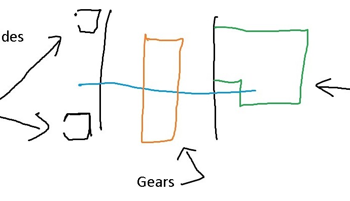

The shifter is hard to explain so I will do my best. Our team has been working on this design since December of 2011 and we have never come across anything similiar to it either. The concept has not actually changed that much since we started designing it. Firstly, there is a motor module as we call it. It is 4 motors attached to a plate. This plate is standoffed to another plate and they sandwich the motor gears in between them. On the side opposite the motors, there are linear slides. The motor module slides back and forth on the drivetrain by a piston pushing it. If the piston is extended, the motor gears will mesh with drive gears that will in turn send power to the wheels. If the piston is retracted, it will mesh the motor gears with a different set of gears creating a different ratio. This set of gears will also send power to the wheels. I’ve created some illustrations to help with understanding. One is of the side of the motor module. The other of is the overall system. We CADed almost every iteration of the drive so I might be able to get some CAD screenshots of it aswell if needed.

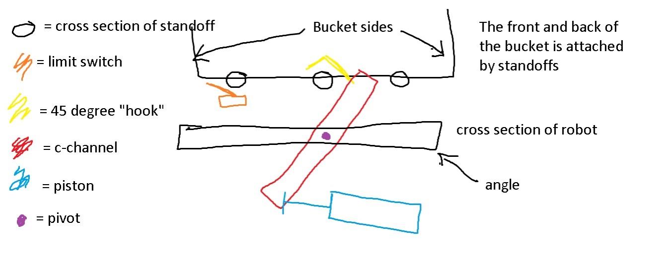

Last questions… How many pistons do you use to lock your basket? and how does it relock automatically? Where are these pistons placed?
At around 2:26 in the release video there is a good clip of it. If you pause the video at 2:26, directly to the left of the rope, there is a small c-channel pointing to the top right of the screen. It has one of those 45 degree plates bolted to it at the top. You can also see the bearing that it pivots on bolted to the angle. The c-channel extends all the way to the bottom of the robot, almost hitting the ground. At the bottom of it, there is a piston attached to it and the drive frame. When it activates, the c-channel pivots back and forth. The 45 degree plate hooks onto a standoff at the bottom of the bucket to hold it down. When the bucket is at the bottom, it presses a limit switch which can also be seen to the left of the c-channel at 2:26. With code, we tell the piston to activate the lock to hold down the bucket when the switch is pressed. I attached a picture of this. We use one single acting piston on the bucket lock. At 4:01, there is a brighter view and you can see the piston extended at the bottom of the robot. During the clip at 1:28, you can see the 45 degree plate lock over the bucket standoff.

How exactly are you attaching sprockets to the gears? The way your drawing looks it looks as if it eats axles for breakfast.

For converting gears to chain, we simply have a gear on the axle being driven by a motor gear. Then, we have a sprocket that turns a wheel on the same axle.
I’m not quite sure what you mean by ‘eating axles’. If you mean that we brake axles, we haven’t had too many problems. We have only twisted 1 axle in about the 1.3 years that we have had this drive. But, we have bent a couple of axles by the piston slamming the motor gears into them. If you mean eating as in uses a lot, yes, it uses more axles than that the standard 4 wheel direct drive layout. But we didn’t run out of axles. We did run out of bearings though.

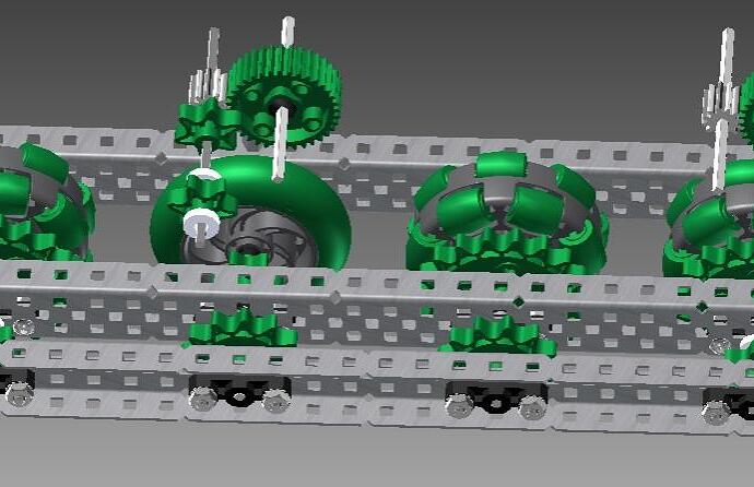

I have dug up an older version of our shifting drive! This version’s official name is Transmission 2.4. In relation to the current drive, it would be the grandfather to what is now version ~3.2. This older version has 10 wheels and only 6 motors on drive. It has gear ratios of 1:3 and 3:1.
The first picture is the overall system with metal.

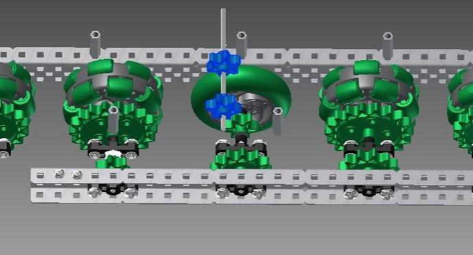

The third picture is of the actual driven axles. The high gear axle has two sprockets on it that are chained to sprockets on wheel axles. The low gear only needed one.

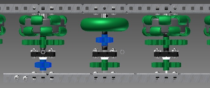

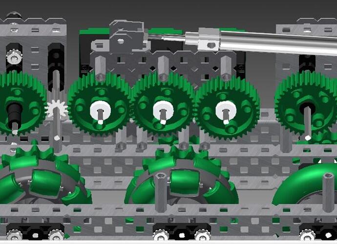

The fourth picture is of just the sprocket axles. The highlighted sprockets get chained to their respective highlighted sprockets in the fifth picture. The rest of the sprockets get chained to the same size sprocket that is beside them to create a system that every wheel is powered by a 1:1 ratio.
