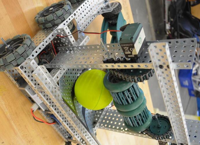

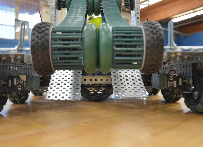

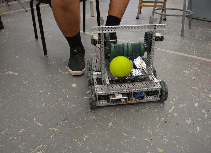

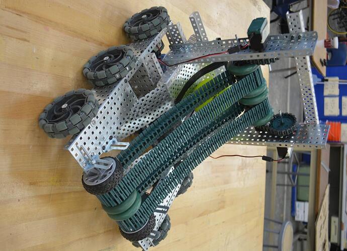

Our first robot done today by our one man team of 4874U Señor RoboDude. His main goal was to build a robot that can be an asset to any alliance. Its a dumper robot either into the low goal or he’s fast enough to pickup and dump into full court shooters intake. Also light enough to be lifted.
Specs:
7 motor(turbo) H Drive
2 motor intake passive raised.

This is the first (EDR) showcase I have seen where the robot is not designed to shoot balls, but rather as assistance to another shooter based robot. Awesome! I also <3 the 7 motor H drive, for when 4 (or 6) motors is not enough :cool: . I would love to see some footage of this in a game though. Glad to see not all robots are just pinball machines, spinning wheels and catapults.

were gonna put up one of our 3 fields today so hopefully by next monday have some video of him picking up balls drifting around. Last time we checked it was around 8 but will weigh it again today and were also thinking of making it all aluminum. Yeah were unique this year.
Great job on the robot! It’s very unique and has an interesting approach to this year’s game. The only problem is that the black and white wheels on the front of the conveyor are not VEX legal. If you plan to use that bot at competition, you probably won’t pass inspection because of those wheels. Try using other VEX legal wheels to replace those. Otherwise, good job!
I believe those are the VEXplorer wheels, which are actually legal.
Those black and white wheels are actually black and silver VEXplorer Wheels and per Karthik here https://vexforum.com/t/answered-vexplorer-wheels-in-nbn/30314/1 are competition legal.
VEXplorer has one or two unique parts that are often useful including its maroon/red 48 tooth gears which fill a nice niche in a 28:1 shooter gear train like 8959A’s. With the 48 tooth you do not need to offset from the tower the 2 motor combination from the 84 tooth primary drive gear.
The Vexplorer wheels are probably the best wheel this year next to omni wheels we have it available to swap out with tiny omni wheels which also work amazing on this pick up.

Just weighed it in at 11.5lbs our sister team a lifting bot lifts us in about 2 sec

:rolleyes: we plan on dumping our preloads into either partner or low goal in auto then collecting up the rest of the field. yeah we can pickup on the fly due to our intake having a passive riser in the front which you might be able to see in the pic. Well the other 3 will be used elsewhere after our first competition to see what we need to improve.
