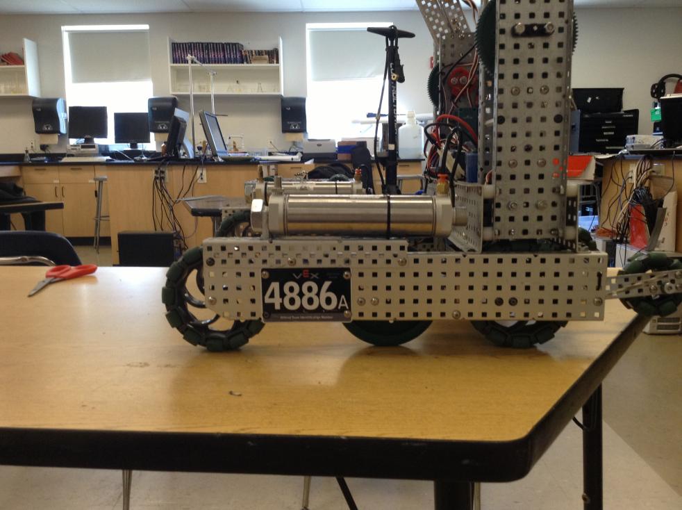

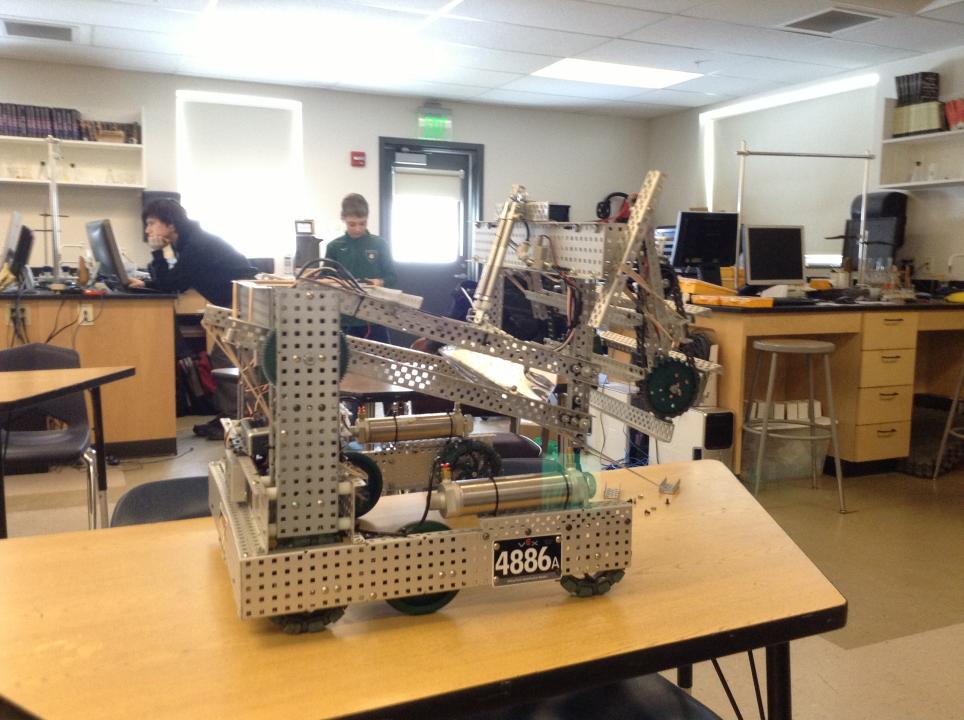

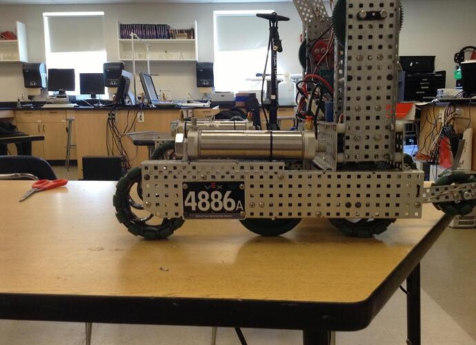

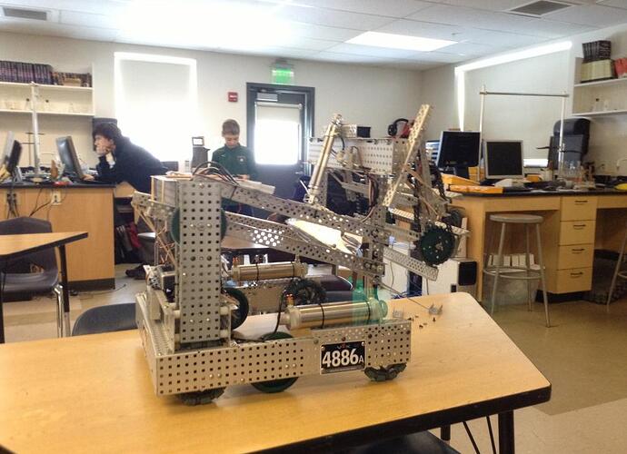

Enough of this wallbot nonsense. Project GLaDOS may have failed, but our team is still alive. This is our robot that won the gold division at our pre-worlds scrimmage, and will be competing next week (more or less, it has changed a little).
https://vexforum.com/attachment.php?attachmentid=7395&stc=1&d=1365727113
Stats:
6 motor 1:1.6 high speed tank drive - fast and powerful
2 motor 7:1 torque lift - max capacity 18 sacks
2 motor metal chainsaw intake (inspired by 2915A’s June robot) with piston-operated polycarb offsetting table
-Quickly gathers sacks from anywhere on the field (5-1-5 in one swoop, same with wallsacks)
-Scores all goals
-Descores all goals
-Gathers all sacks from a 14-15 inch wide section of trough into intake in 3-4 seconds
-Does not get stuck on sacks
-Variable autonomous
-Retuned and ready to go on mats treated with anti-static spray
The goal of this robot was to have a design with all the abilities of a “NZ robot” but also have a six motor drive for strength and general reliability and robustness. I think we pulled it off quite nicely.

Pictures!
whole robot - https://vexforum.com/attachment.php?attachmentid=7395&stc=1&d=1365727113

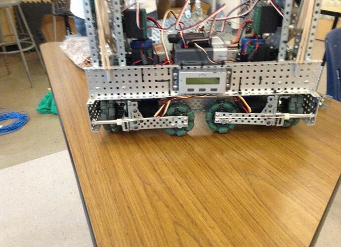

new drivebase for picking up wallsacks - https://vexforum.com/attachment.php?attachmentid=7397&stc=1&d=1365728372
back anti-tip wheels (inspired by 1615A) - https://vexforum.com/attachment.php?attachmentid=7396&stc=1&d=1365728372
It looks like a really nice nz bot. Does it have a high goal flipper or with the six-bar can it just reach that height with the intake?
Watch this video. It shows everything.
Its labeled general promo in the reveal.
It has a lever-powered high goal flipper which can put 6 loads nicely on the high goal. It can also descore the high goal. The lift is a four bar.

Yeah, we didn’t want to redesign to the 4 bar because it would have required a full on drive change. It gets a little extra power from pistons to make up for the extra length of the six bar. How well does your chassis do at driving over sack piles or do you not feel like its enough of an issue to worry about?
Our chassis doesn’t get stuck at all on sacks, ah the power of 6 motor drive.
