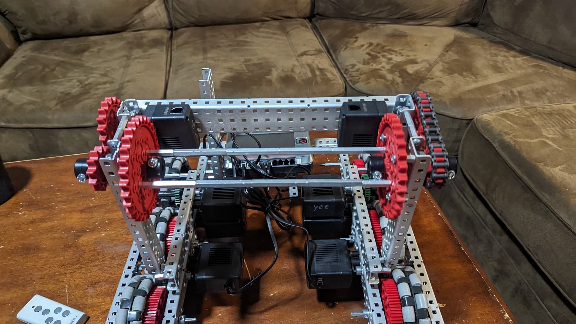

Hi–
Did you have any experience connecting the 5.5w motor to high strength shaft? We would like to connect two 5.5w motors to power the intake.
Thanks

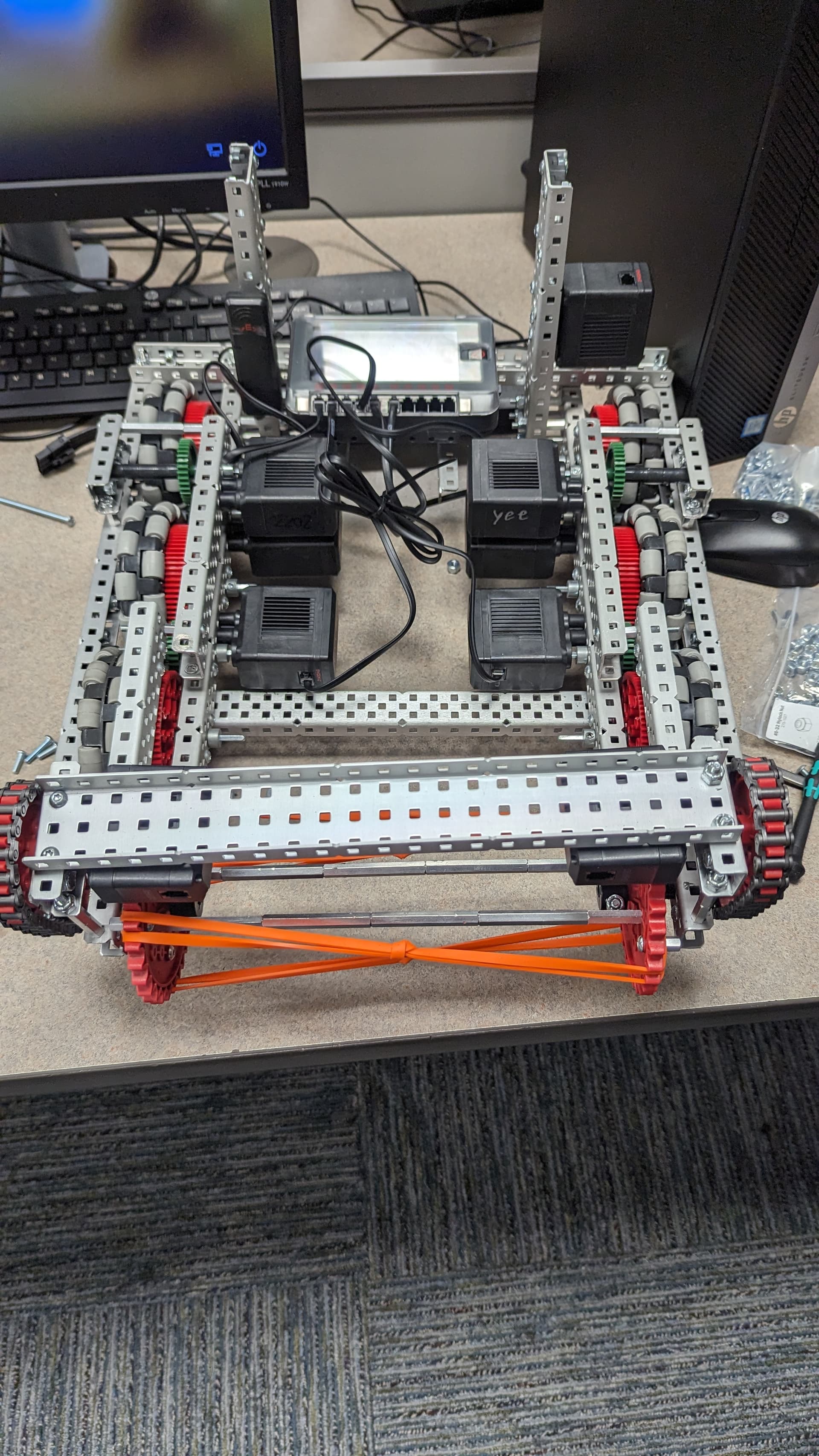

The way you do it is with a motion transmitter like gears or sprockets/chain. Use high strength stuff but put LS inserts in the one with the motor shaft. I will attach pictures of our intake from when we hadn’t put the non-slip mat.
