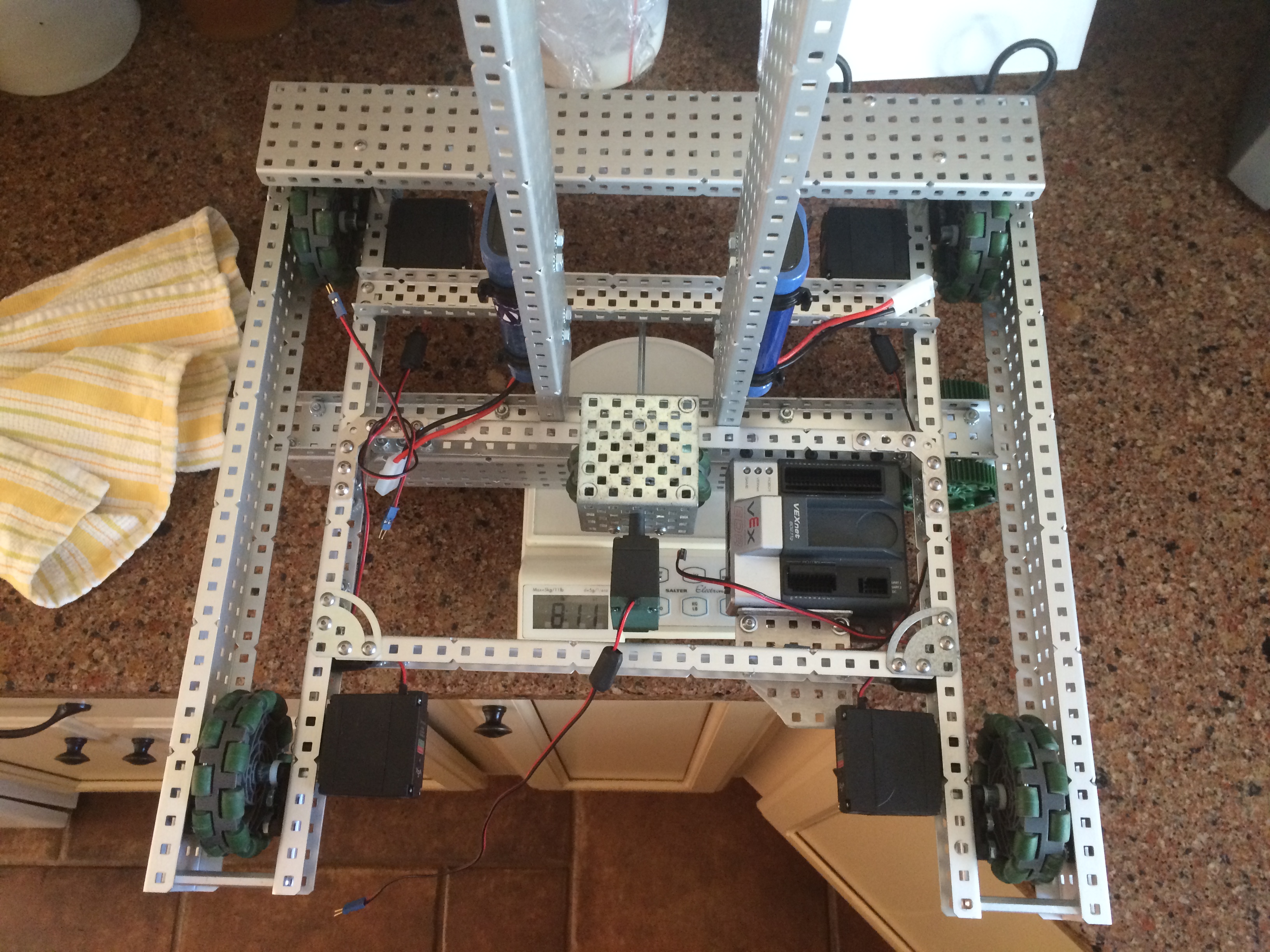

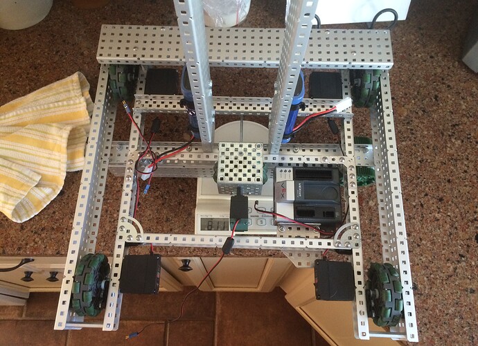

If you can code it, go for a single strafing H-Drive. We built one - see attached pic. I will warn you though. Be VERY careful about this drive setup. Unlike using the normal 2 wheels for strafing in an H-Drive, this has just one, meaning it doesn’t “rest” or “grip” the ground as well as the others. (Think about how the weight is distributed.) You’d have to have wheels perfectly in plane with each other (which will never happen.) We had major problems where the center wheel couldn’t grip the ground and would just spin freely. We are currently designing a suspension system to maintain that wheel’s grip to the floor.
What kind of lift do you currently?
mecanum drive with a single omni in the center :stuck_out_tongue:

Just lower the center wheel, so that it would rock back and forth on a hard surface, but it will sink in on the foam.
@Oedipus Vex The problem is that then driving strait would be greatly impaired by the wheel digging in. I’m trying to stop that.
