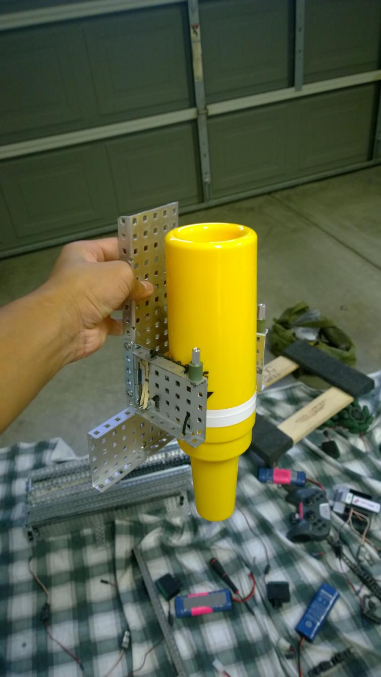

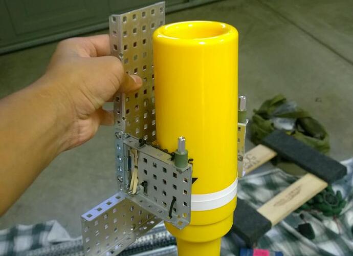

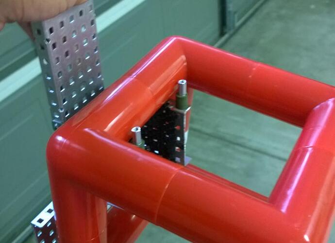

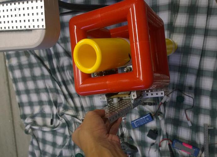

507P from Mustang Robotics just wanted to share with you all our decommissioned intake, which is what we personally believe, the easiest possible intake without using any motors, pneumatics blah blah. It’s pretty much just a tower piece clamp also serving as hooks to pick up single cubes. Or maybe they’re actually hooks serving as a clamp for tower pieces??? We may never know. As far as we could tell, it can pretty much work with most types of lifts so it serves as a neat last minute design when we need it.

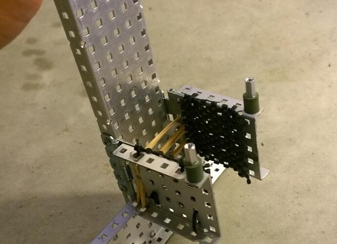

Looks great! Did you use the thin or thick rubber mat for that?
We doubled a thin rubber mat!
