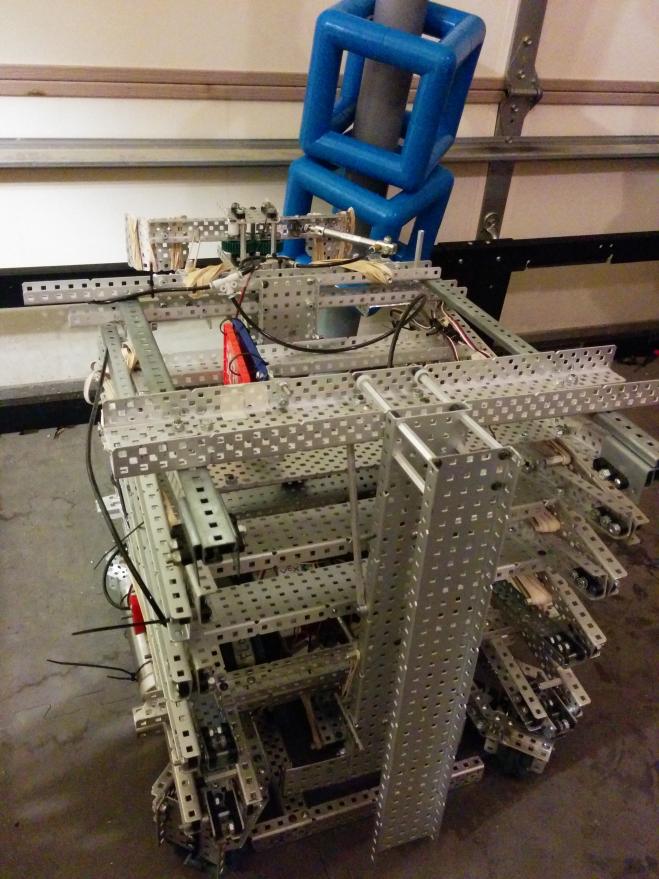

5278A NYAN~NYAN is a hybrid skyrise stacking and cube scoring robot, with a primarily skyrise focus. NYAN~NYAN is a 6-motor 4-stage scissor geared 1:7, capable of stacking 7 skyrises and scoring on 6 skyrises with a 2-cube pneumatic intake. The base consists of a 4-motor x-drive, internally geared for speed with 3.25" wheels. NYAN~NYAN contains a backwards facing flip out pneumatic claw, and in combination with a piston powered turntable on the base, can score skyrises with accuracy and ease.

NYAN~NYAN is a primarily stacking robot, able to stack skyrises easily with its piston-actuated pivot. While it focuses on skyrises, a two cube pneumatic intake ensures that it can play both roles of the game. The x-drive (3.25" wheels geared for speed) is also remarkably fast and reliable, allowing this robot to maneuver and score cubes efficiently when the skyrise is done. NYAN~NYAN is a powerful all-around robot able to match others in both skyrise and cube capabilities.
