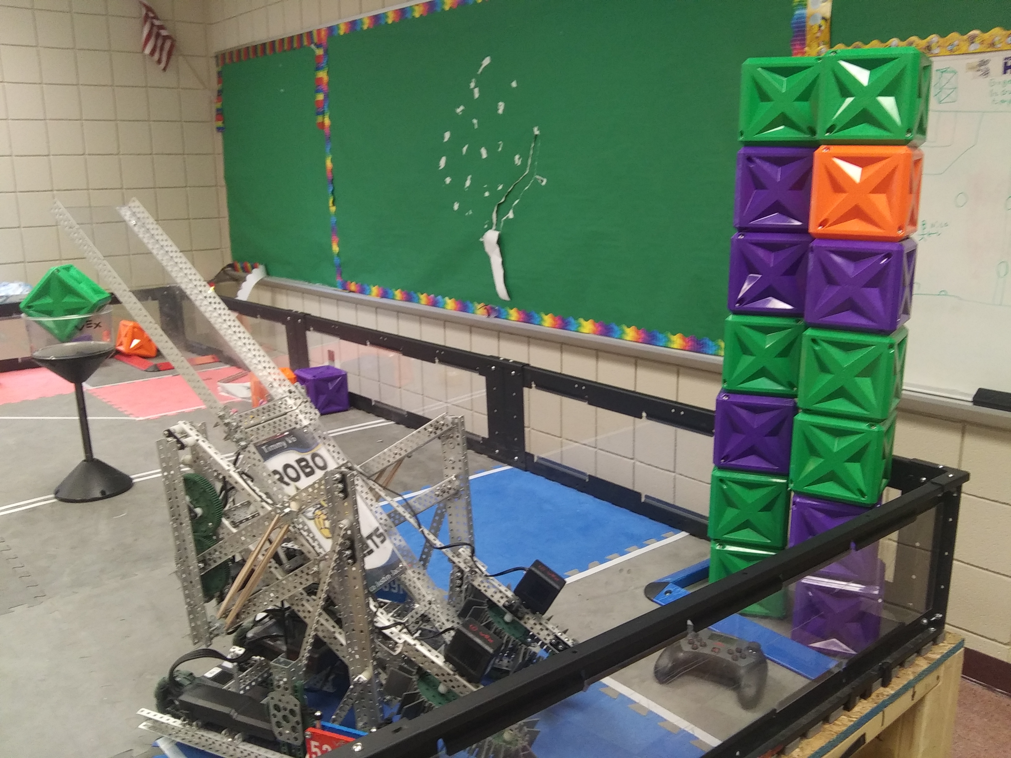

I noticed your drive base is fairly wide. Are you able to place two stacks in the larger goal zone?

Nope. We are fixing that for next competition though. We can’t even get in the small zone with more than 4 cubes
Question about tray tilters. When going for 9 cubes is it better to use a compound ratio for 1:15(1:3 and 1:5) or 1:25(1:5 and 1:5)? Is 1:25 necessary or will 1:15 do the job fine?
For many teams, a well built 1:7 is enough. From what I have seen, 1:15 should be enough to get the job done.
1:15 may work well for early season, but as the bots get faster a 1:7 may be necessary. A little bit of speed may be necessary to get around defense as well.
I think 1:7 works. I had a 1:7 with a single 393 motor until I switched to v5 last week, and it could no 7 cubes no problem

Our current robot uses a 100RPM 5:1 ratio and it works fine. Granted, it only moves 7 cubes right now because we took off the third stage of our tray, but it did work with 9.
Make your front and back rollers the same size, and use smaller flaps. It seems that once you get the cube into the intake, the back rollers intake them fine, but it looked like the front rollers didn’t do too much to help. Smaller flaps are less flimsy than the larger ones, so using them will add more compression, and if that means you have to either use bigger sprockets or bring them closer to the center, so be it. If you are completely rebuilding the intake to try the layered rollers, make sure you also lock them in place better, your rollers seemed to move around a lot in the reveal…
Update: The robot is now able to place 2 stacks of 7 in the large zone and 1 stack of 7 in the smaller zone. We moved the intakes slightly further back and I did a little driver practice. Next is the telescoping tray. Also, the tray gear ratio is now 1:15 and works great. Thanks guys!
Has anybody tried rubber banding their tray…?
I thought about it but it seems to me like with the forces of the bands, the tray might go past vertical and push the stack over. With some kind of stop it might be worth a try.
I’d make sure that your arm when fully extended only goes to 90deg on the stack. You can also do a P control loop to slow down the tilter as you tilt up.
I like your robot, but I have a couple of questions. Have you been having issues with tipping despite the ant tip on your lift, or your intake breaking?
We have an unusually large base so there is no problem with the lift down holding a full stack but when the lift is up if I don’t drive carefully we can tip. We haven’t tipped so far, even outside of competition
