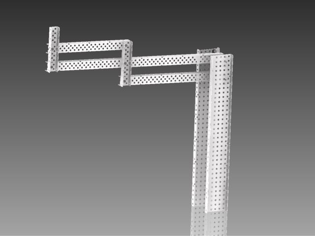

I need some help building a 6 bar.
I understand how to build a 4 bar, I just can’t figure out a 6 bar from the pictures I have seen.
Does anyone have a top view of a 6 bar lift mechanism?
Thanks!

Our team took our first dive into building on also and it really is quite simple. It is very similar to building two 4-bar lifts stacked on top of each other, connected by a vertical bar. If you look at the photos on the AURA website, you will see what I mean. If you still need help, and no other more advanced builder answer your question better than I can :p, I could whip up a diagram to show you what I mean.
William

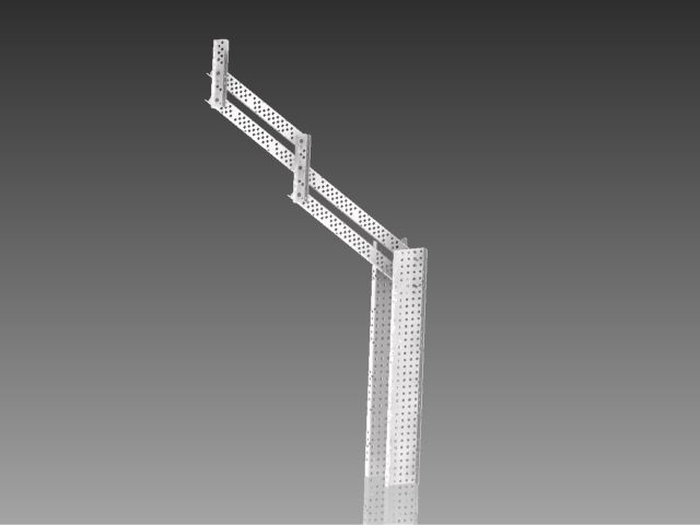

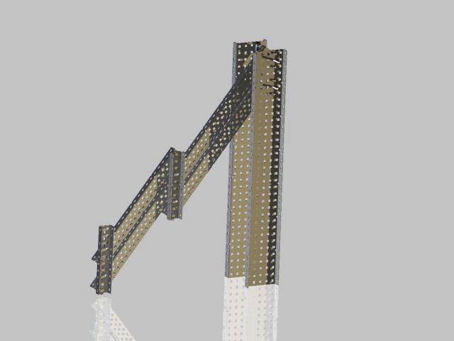

It is simply 1.5 four bars. It is just a linkage in the middle i think that is confusing you. Here is a pic of one CADded
Hope this helps
