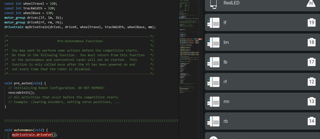

Our team has switched the drivetrain from a 4 motor, 4 wheel drive to a 6 motor, 4 wheel drive. And I don’t know how to make the separate motors (lf, lm, lb, rf, rm, rb) in to one name called “drivetrain”. I’ve seen other posts about coding 6 motor drivetrains but I don’t know how to implement them into what I need.
I just want to know how I can add all 6 motors in to the name drivetrain to then add to auton
so I’m able to use the driveFor function.

If you look at the VEX API documentation for the drivetrain (drivetrain constructor) it shows that the first two arguments are motor groups named l and r. These correspond to your left and right drivetrain motors respectively.
Now, the motor group (motor_group constructor) is constructed through 2 (or more) motor arguments (the ... means an unlimited number of arguments can go there.)
So, what you need to do is create 2 motor groups, one with your three left motors and one with your three right motors. Afterwards, you can pass those into the drivetrain constructor along with all other needed parameters.
Hope this helps!
like this?
Looks correct to me! If it doesn’t work, come back to this thread and I’ll be glad to help.
If you look at the bottom of the screenshot it gives me an error when using the driveFor command. And when I used this on another program it works.
What’s the error? It might be because you don’t have the parameters.
myDrivetrain.driveFor(forward, 15, inches);
