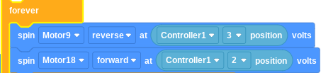

Here is what we did for our six motor drive.
what portion auton for like a PID or driver control our team uses a 6motor drive and we use codeblocks
Also it is possible to do it using bothe the 4 motor drive train code and 2 motor drive train code but it is both sketchy and unreliable.
Also you could make two three-motor motor groups. It would not be a drivetrain configuration, but it would be better than calling each motor individually.

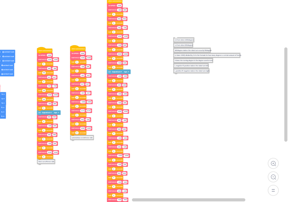

Does anyone know how to code a 6 motor drive in v5 blocks for autonomous?
Please look through this topic or the forum before you post. It has already been answered.

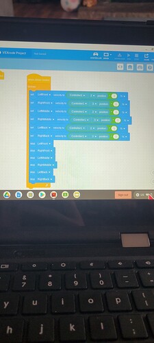

My jank and probably problematic answer
Do what was shown above, put each motor under it’s own driver control and forever loop (so you’d end up with 6 “when driver control, forever loop, set motor X velocity to controller axis Y, stop motor X”)
Try using a 4-motor drivetrain preset then have the other 2 motors as individual motors and bind them with the controller thumbpads as shown in the photo in an infinite loop.

That example is for when driver control. I am looking for when autonomous.
If you would look i have a topic on this conversation
Oh, sorry.
I would go to @Antastic 's topic:
It’s long, but maybe you can help him find a way to shorten it :slight_smile:
We have found a way to do it
My team programmed our 6 motor drivetrain by calling all motors individually. You can make a few motor groups if you want. There is no 6 motor drivetrain for Vex Blocky sadly so you have to manually code buttons and call motors. It works fine for my team. Its just a little extra effort.
