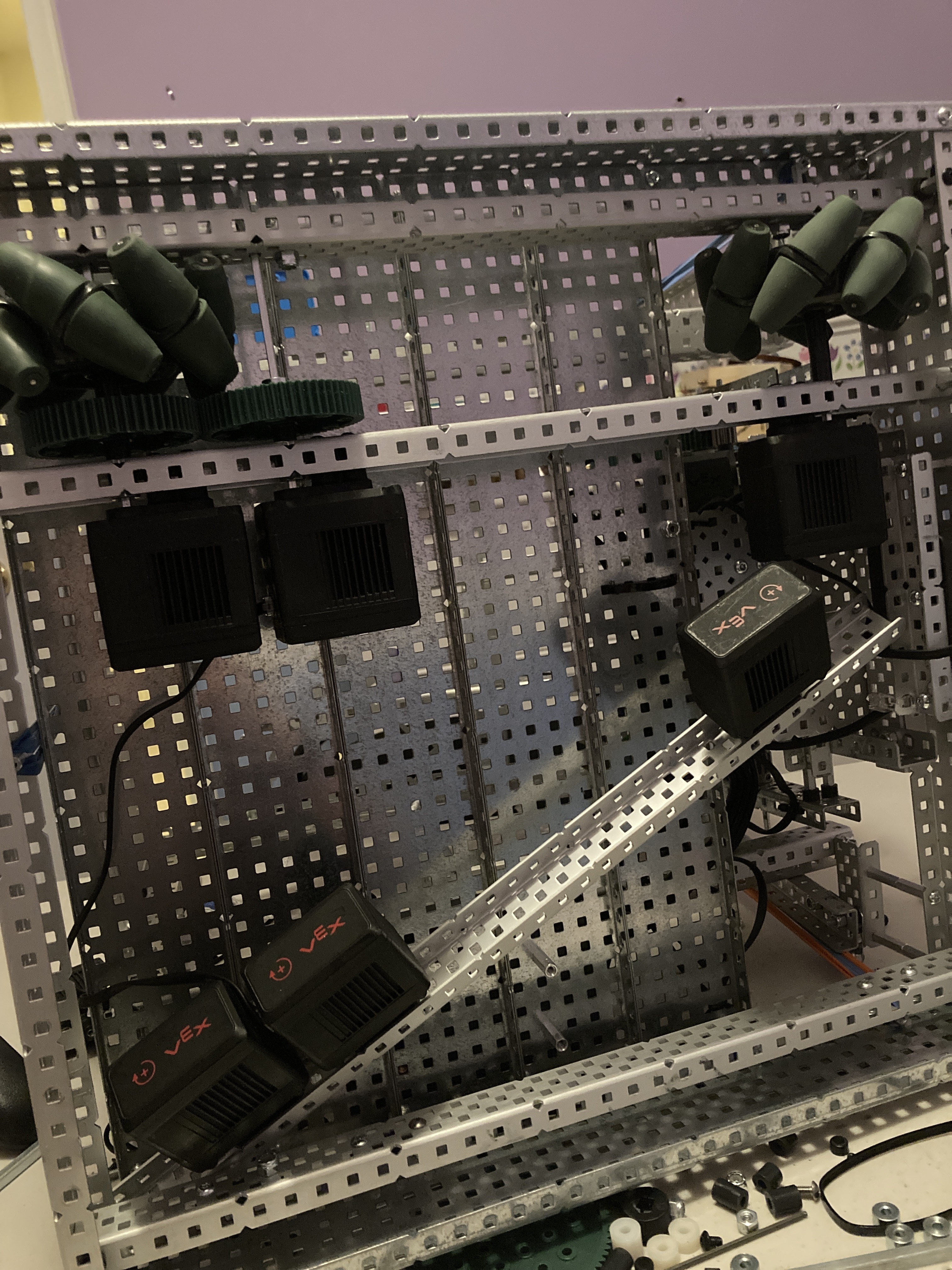

Hi there Our programmer needs help with the program when our robot base looks like this.
. She doesn’t know how to program a drive like that and I was wondering if anyone else has a program for that drive.
Does she know how to program a normal mecanum drive?
The easiest way to handle that drivetrain would be to simply configure motor groups for the two double-motor wheels. One of the motors in that group would have to be reversed, due to the gearing.
You can then use that motor group as if it was just another motor.
Due to handling quirks, I would recommend calculating the velocity for all of the wheels and storing them in variables, then set the motor speeds in adjacent lines (don’t set motor 1 speed, do a bunch of calculations, set motor 2 speed, etc).
Good luck! I will be curious to hear how that drive base design works. I don’t think I have seen that motor layout used before.
Yeah we are a shopping cart and needed more strength to get the mobile goals up the platform. Thank you so much :pray:
where are the other two wheels?
Looks like they go on that slanted bar. To me that was a pretty helpful picture to show more of the inside setup.
Me too. For some reason I had mechanum locked into a 4 wheel / 4 motor design, so using 6 motors is an interesting concept.
Using VexCodePro with a basic Robot Configuration
Then referencing @Codec’s example here but transformed to use motor groups in the rear:
void usercontrol(void) {
  // User control code here, inside the loop
  while (1) {
    int forward = Controller1.Axis3.position(vex::percent);
    int sideways = Controller1.Axis4.position(vex::percent);
    int turn = Controller1.Axis1.position(vex::percent);
    RF.spin(vex::forward, forward - sideways + turn, vex::percent);
    LF.spin(vex::forward,  forward + sideways - turn, vex::percent);
    RRGroup.spin(vex::forward,  forward + sideways + turn, vex::percent);
    LRGroup.spin(vex::forward,   forward - sideways - turn, vex::percent);

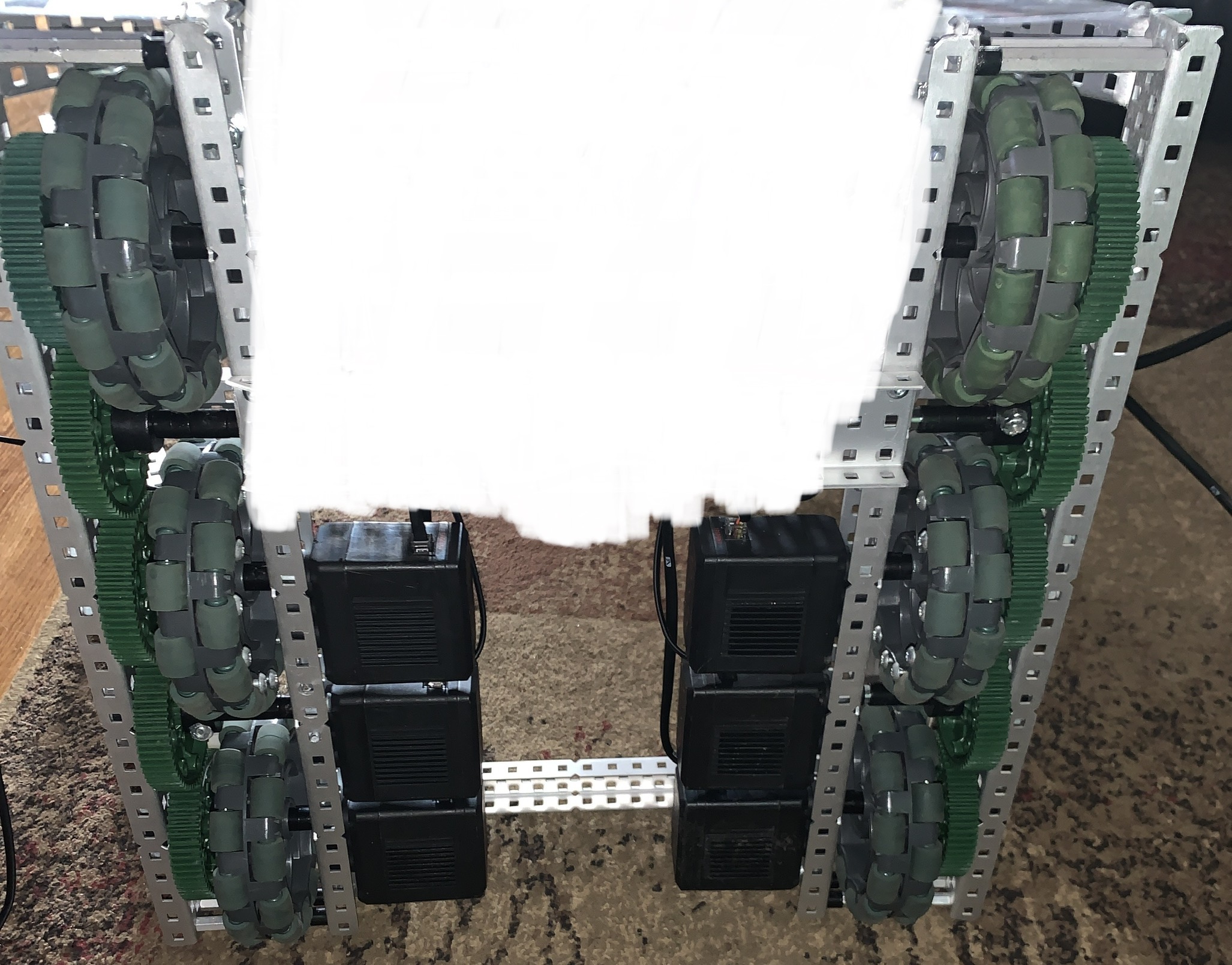

Here is a old picture of our drivetrain… It can easily climb with all the goals in the shopping cart…
Is this picture looking down from the top or up from the bottom?
If it is up from the bottom you have the rollers aligned incorrectly (the robot can be spun in place without any motors turning).
