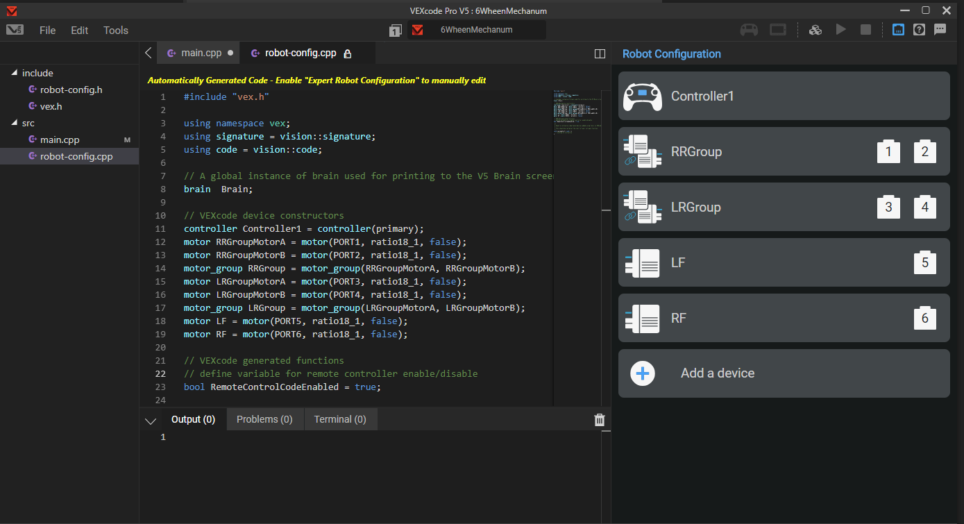

6 motor mechanum drive
Using VexCodePro with a basic Robot Configuration
Then referencing @Codec’s example here but transformed to use motor groups in the rear:
