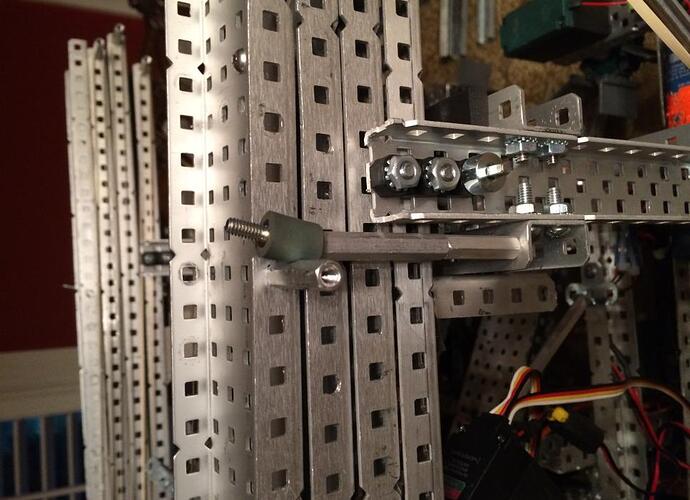

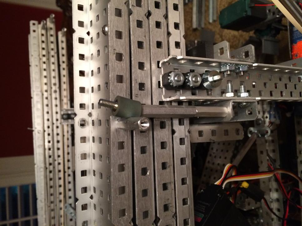

Some people on the forums have expressed interest in a quick reveal of our lifting mechanism so here it goes!
Specs:
• 4 pistons total cause the ramp to picot and deploy with a latching mechanism
-2 single acting and 2 double acting pistons
• Elastic expansion and deployment in less than a second
• 5- 10 second elevation
• 26 degree angle ramp
• 4 stage linear slides expanded by rubber bands
• High lift 14 inches
• Lifts up to a 20 pound robot with elastic and pneumatic assist
Today we competed in the Lambert competition in Suwanee, Georgia and scored a total of 229 points in a qualification match with 675B and used the ramp to gain an extra 50 points (I wish I had a video of the match). http://www.robotevents.com/re-vrc-15-3032.html
I am posting pictures and a video of the ramp in action.
Also, the robot pictured is not our current robot due to us not wanting to reveal the full robot at this time but the lift concept is the same on our current robot. The videos are of our competition robot as well as our summer robot.
Please let me know if there are any questions and I will be happy to answer them!

Very Nice!
Have any robots had issues driving up your lift ( even at 26 degrees ) and do you use the weight of the robot to assist pushing the platform up (along with the pneumatic assist and rubber bands ) and have you had any issues fitting it all in the expanding zone?
If a robot is too low to the ground, their drive will scrape but if the robot is 0.5 inches above the ground with sufficient motor power they have no problem getting up the ramp.
and yes we use the weight of the other robot to also help level the ramp when the robot gets to the top.
It all fits in the expanding zone and now we back into the corner to get a larger area to expand in to ensure that we are in the zone. This was the smallest angle that we could get while still being in the expansion area.

That angle looks very steep…
what happens if the robots drive is not the exact same width as your ramp, do you have plans to add plates or something to let teams with different sized drives get up?
the angle of the ramp is as low as possible without expanding out of the lifting area.
We have plans for a new lift that will accommodate any size robot but we chose this width for our first design because most competition robots tend to be full size.

We were able to get up the ramp quickly and efficiently with motors geared to high speed (after lifting our robot’s chassis half an inch.) I’m pretty sure any full size robot can make it up 675E’s ramp as long as their robot is not sitting too low.
We did not have that issue during our first competition yesterday, however we do anticipate defense to be a problem in future competitions due to the high amount of defense being played against us while shooting in the finals. I’m sure it will be the same with the ramp eventually.

Yes we can go up a ramp similar to our own but it would have to be narrower to fit our drive width. The ramp is also easily removable as we did during elimination matches to reduce weight if it is not used. We made our drive narrower to fit on other style ramps if we were to come across them.
And we have not had any problems with our intake being too fast.
