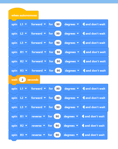

6M drivetrain autonomous in block
recently won the irish national final, was running 4M drivetrain on 5:3 with 8 wheels. its okay but overheating when pushing other bots. For worlds I really want 6M drive but don’t have the time to learn script code. Could somebody please help me with this. Down below is an idea I had for autonomous but I’m not sure if it would work.

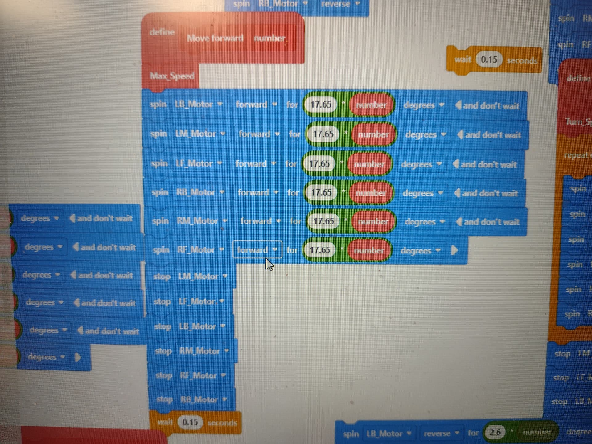

This is what I used and it worked perfectly (my drivebase ratio is 400 rpm with 3.25 inch wheels so you may have to calculate the degree number I put)
