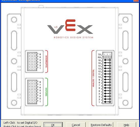

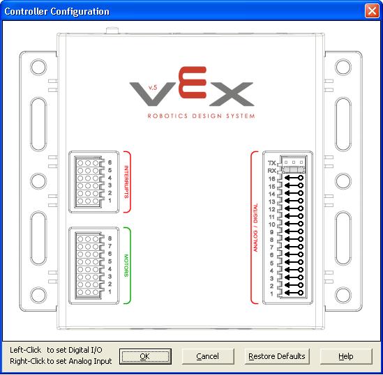

Just so you guys know in easyC you can re-define all the I/O pins as digital outputs.
https://vexforum.com/attachment.php?attachmentid=2106&d=1251919771
Can you change the interrupt ports on the Vex Controller to be general input or outputs using Easy C or Easy C Pro?
I don’t know about EasyC Pro but with EasyC you cannot.
