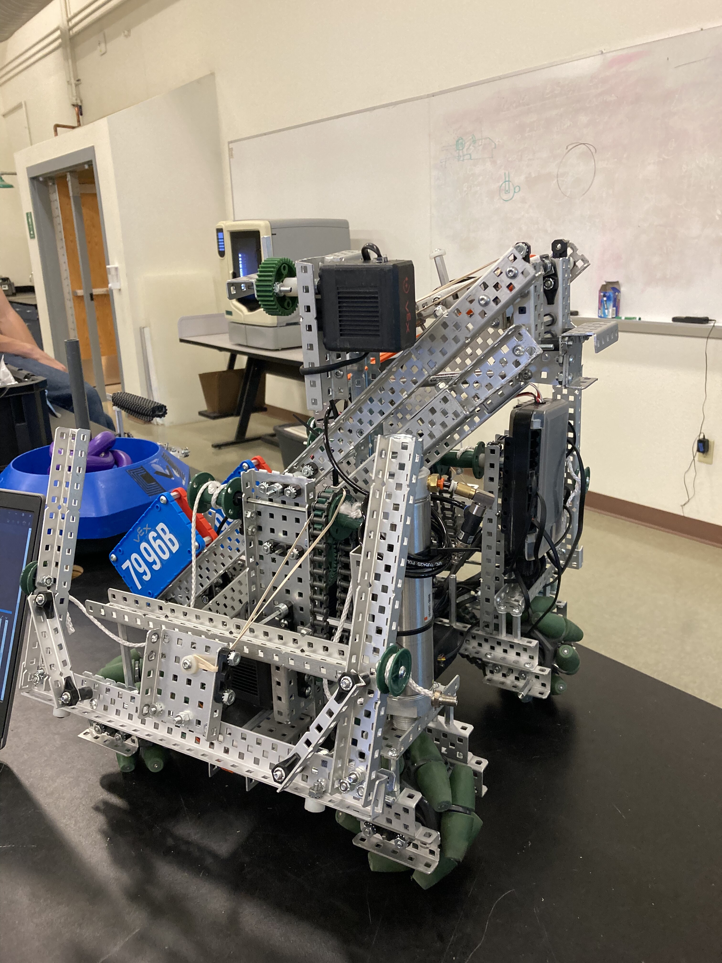

2 motor side lifts (1 right,1 left)

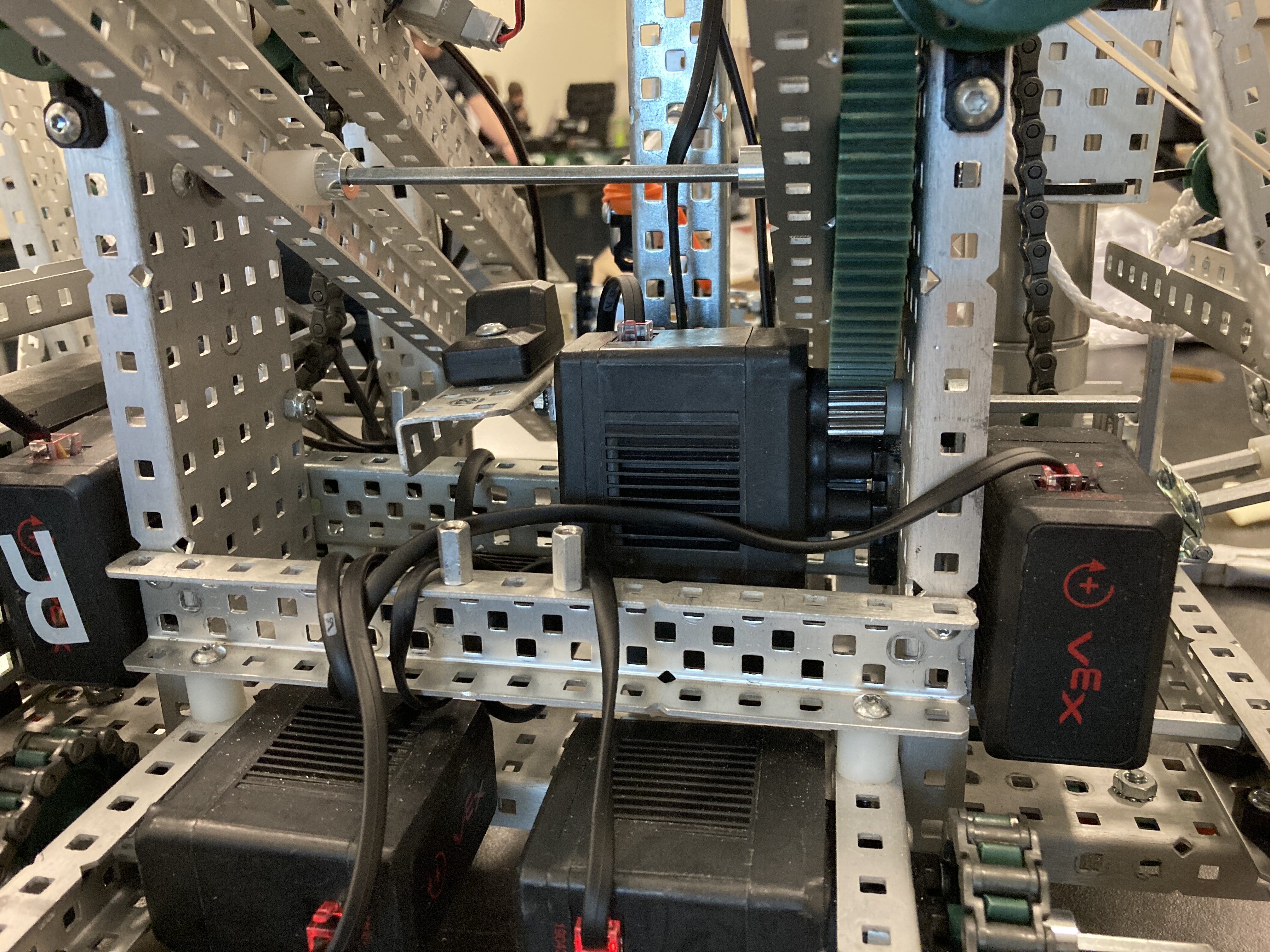

1 absolutely pointless motor (for preloads only)
preload motor will be replaced for an intake after this next competition

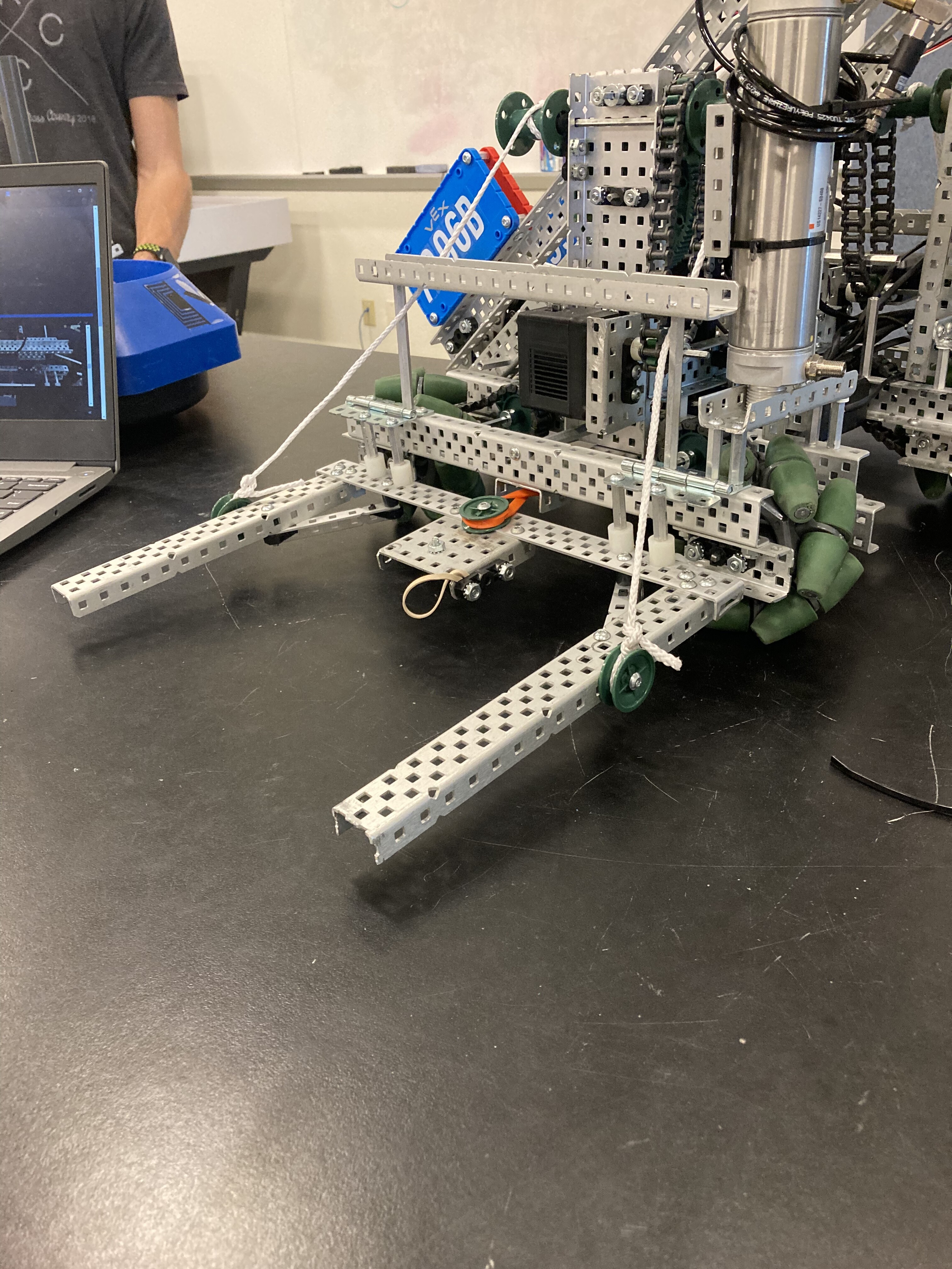

2 pneumatic claws (one folds out to stay in the height limit)

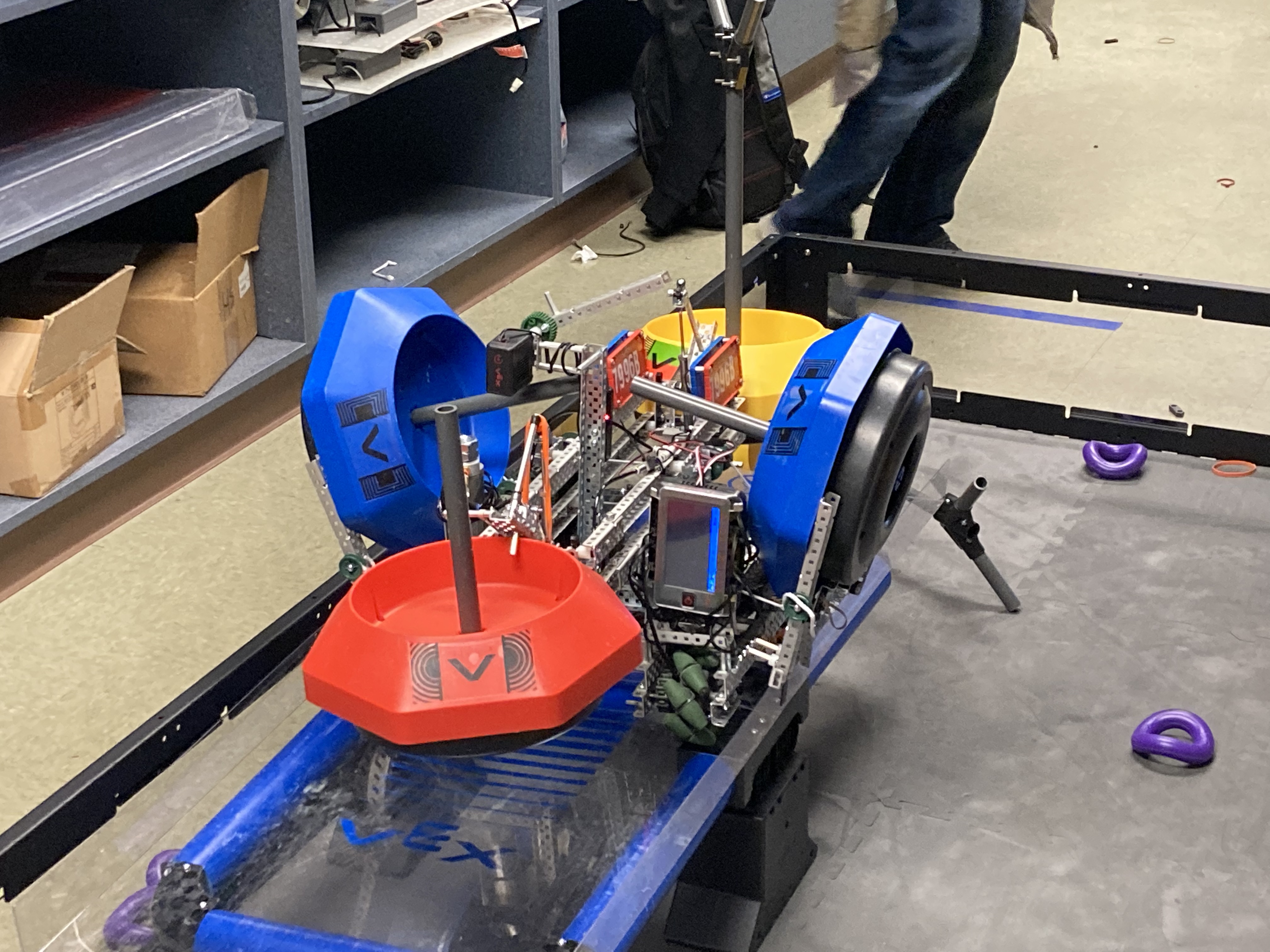

4 MOGOs at a time

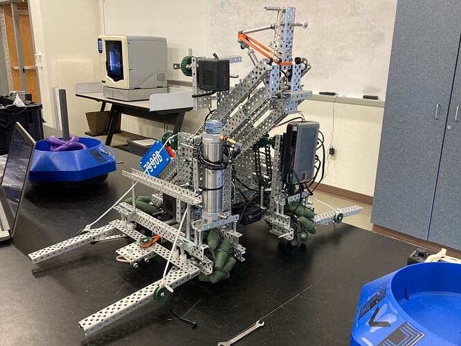

robot folded up^
the robot unfolded ^
the one motor that moves the lift ^

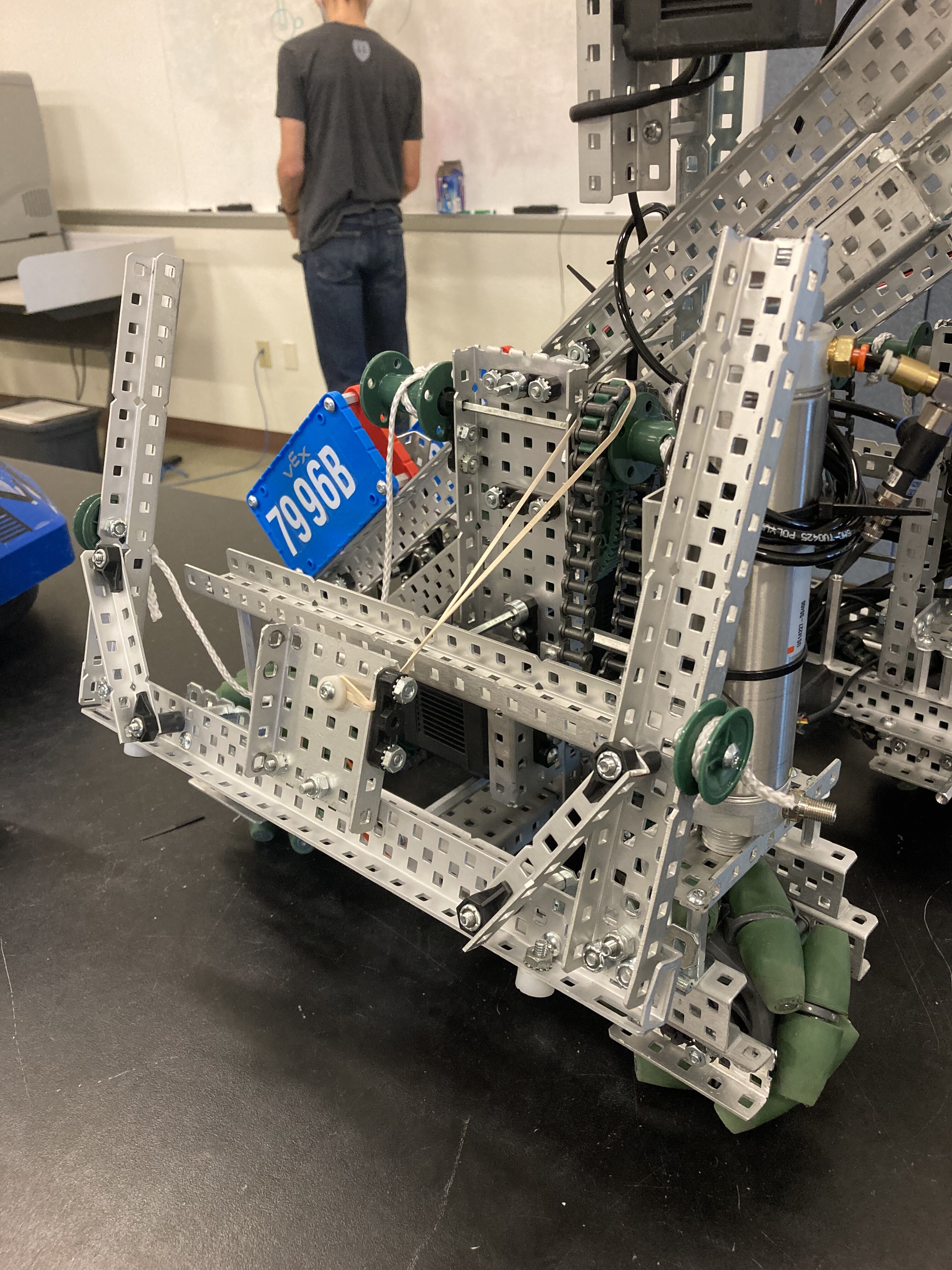

one of the side lifts folded^
one of the side lifts unfolded^
pneumatic claw^
the claw that can fold out ^
four MOGO parking with room for alliance partner (when lift is all the way up)^

looks interesting! Would you be willing to explain how the claw folds out?
The claw is just a triangle with each of the corners being able to rotate, and one of the sides being able to expand with the pneumatic cylinder, when the claw unfolds completely, the screw and c-channel lock together so that it can’t bend back again.
