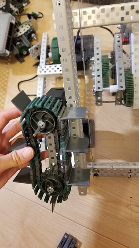

For the rollers, how do they move out of the way when the tray is brought forwards? My rollers block the tray from moving forwards.20190818_210625
Correct me if I’m wrong but They have theirs flip out from the sides, and thus they are simply pushed aside when the tray goes forward
Ah I see.
I was thinking about those but I was hoping for something easier
i do think if the main intention is to stack, then it is definitely good enough.
and also bear in mind that this Ri1D only need 7 motors. So you do have one more motor to play with… for your tower-play.
it is difficult to tell from the pic… but i suspect you will just need to play around with the angle of your rollers, so that the tray can be tilted forward.
and btw, we do make use of the rollers to outtake the cubes as we tilt the tray forward.
