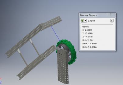

Just wondering, what is the compression of the ball between the flywheel and the back-plate?
Zero burnt out for all these 3 robots.
Wasn’t exactly sure how to quantify how much the ball is compressed so here are a few pictures of the compression between the flywheel and the back-plate. The compression for each robot is slightly different.
59A:
59F:
59K:
Hope this helps!

How much space do you have between the flywheel and the metal that the ball is rolling off of? (I might have worded that badly)
I don’t quite understand your question. Are you talking about how much the ball is compressed as it leaves the shooter? If so, we have already posted pictures showing the how much compression our flywheels offer.
Probably 4" as that is the size of the ball :slight_smile:
I think that he was asking about the amount of space between the wheel and the top c-channel or other metal being used as a compression plate. It should be a little under four inches though, because it is allowing the balls to be compressed a bit smaller.
From the pictures the A bot looks like it might be exactly 4"(or slightly under) while the other robots appear to be leaving less room allowing the balls to be compressed more.
I do understand what he is asking for actually.
But I thought all it requires is to look at the length of the stand-off my boys are using and put the c-channel there and the exact dimension will be out.
But end of the day, it is quite meaningless to copy exactly the dimension. The wheels used could be slightly different in dimension, the zip ties might make a difference, the motors will be different, etc… it is more important to do it up and then do the fine-tuning.
Like what I always tell my teams - it is always that 1mm difference that made a big difference to the performance.
Well, I didn’t have much else to do after finishing a computing assignment and I saw this question:
So logically I made a rough CAD model on some of the pictures posted in the thread
https://vexforum.com/attachment.php?attachmentid=9491&stc=1&d=1436508612
I got a compression of around 1/2", but that could be wrong if I’ve misjudged spacings, so I’d say 1/2" - 1/4"?
I don’t know if anyone who actually worked on the robot’s can confirm, I’d be interested to see. (this is of the A robot)
