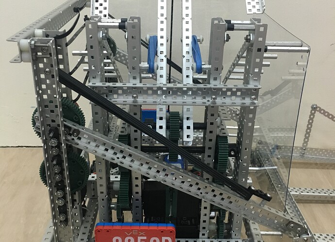

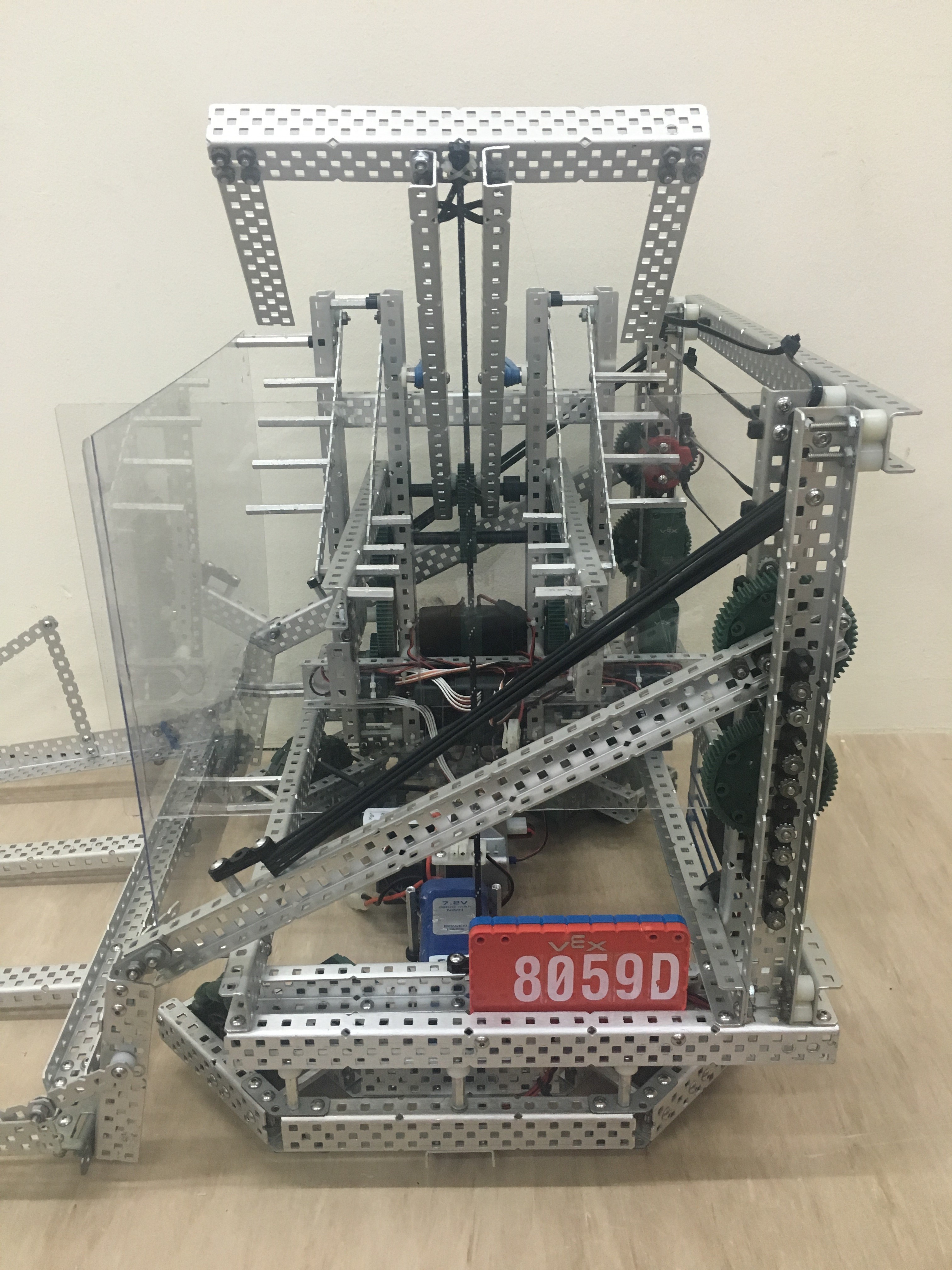

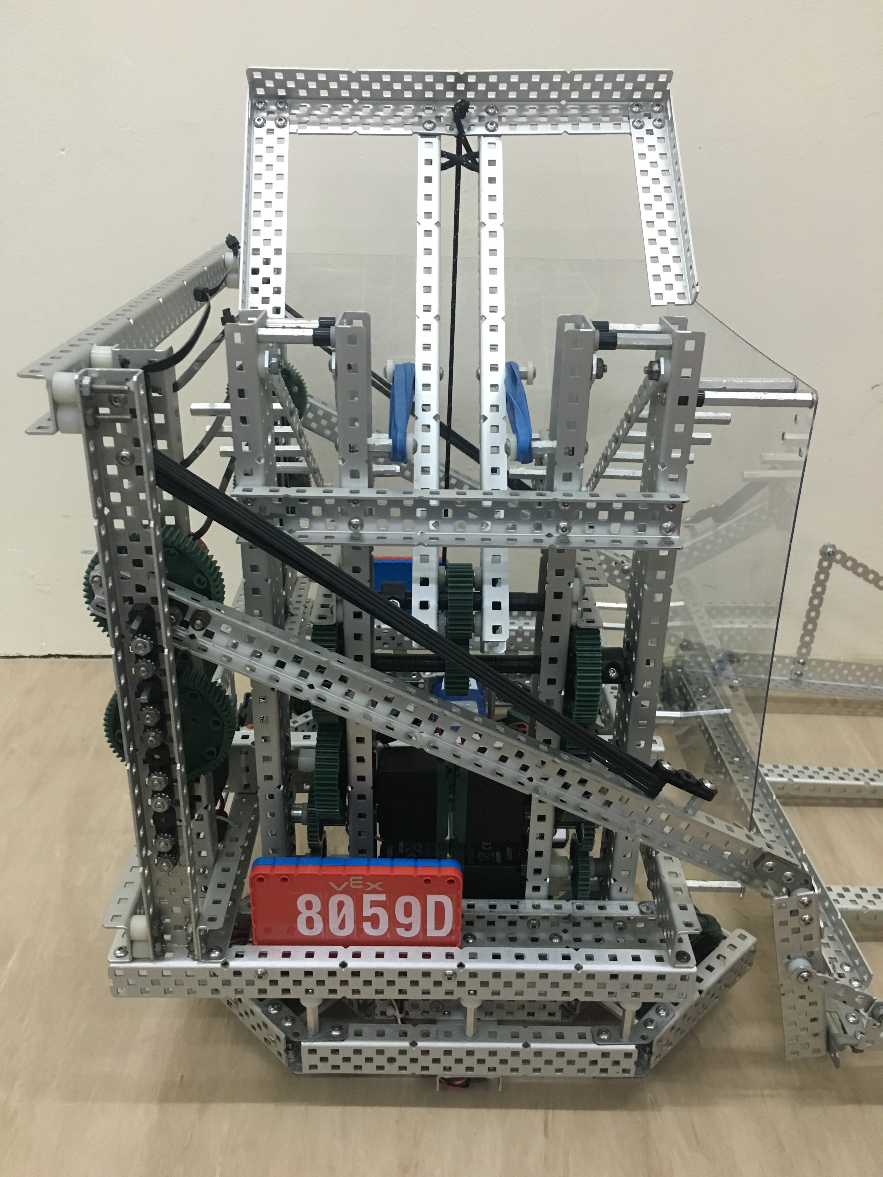

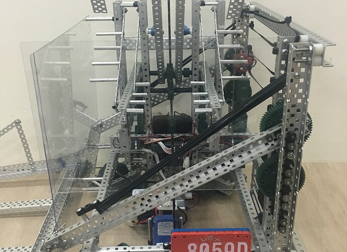

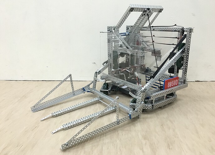

This robot has 2 methods of scoring, by reverse dumping the stars/cubes or by launching the stars/cubes with the catapult. The dumper is also used to lift stars onto the catapult tray in the robot.
Specifications:
Holonomic drivetrain
4 motors with internal speed gearing (1.6), direct drive
4 3.25’’ Omni-Wheels
Dumper
4 motors with internal speed gearing (1.6), geared 1:5
Flip-down scoop
Latex assisted
Catapult
4 motors with internal strength gearing (1.0), geared 1:5

More pictures uploaded.
