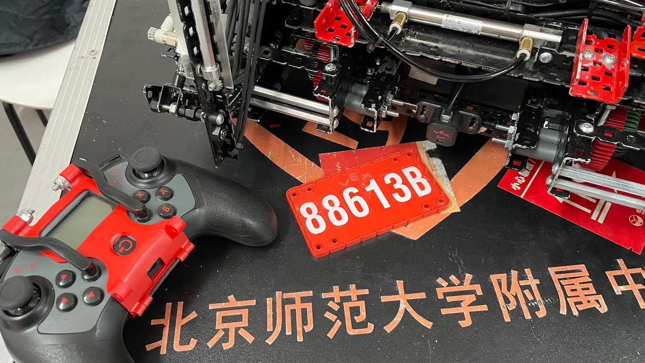

Well, what an unexpected ending for this season and for my retirement.
To be frankly, I’ve imagined so many scenes of becoming a champion in the competition by the time that I finished this unprecedentedly powerful guy.
But, thanks to the epidemic and the policies. It is these unforeseen circumstances ruined our last chance to participate in the competition.
I’ve devoted a massive amount of time since the season “Skyrise” and I’ve learnt a lot and gained so much precious memories throughout these years. I’d say that I can say farewell to VEX without feeling bad, but I sometimes will feel sorry for not being able to participate in a world championship.
This big guy, boasting a striking loading capacity of 3 mobiles goals simultaneously. We also equipped it with a transmission gearbox to shift from the mode of climbing to the mode of sprinting instantly. We also rendered it the function to shoot rings to the highest branch of the mobile goal with an amazing accuracy. I started to build it since September and I kept on optimizing it until our school told me that we are forced to give up possible opportunities to participate in the game due to the policies. I can say without doubt that this guy is the finest robot that I have ever made because it is so sophisticated and so powerful.
Besides the pandemic, there’s another reason that I will enter the college next year so I must cease my VEX career to prepare for my college entrance exam, which also deprived the chance to run prizes for me and for the team.
Hope everything can goes on well and say farewell to the final edition!

Wow that is a thing of beauty. Very, very nice build. Love the action, mogo and rings. And you had 4 cubic cm of space inside left over!
Need a disclaimer on the video that No Bears Were Hurt in the Creation of this Video.

This is really one of the best engineered robot for this season.

This is amazing. Would you mind if I ask about the motor/piston configuration?

It’s a pretty incredible robot. Would like to know more abouts it’s motor and pneumatics distribution.

One question though. What was the point of cutting the flaps into triangles?

Which part is called triangles flaps in my robot ?
I am not a native speaker so I don‘t know how to say each part’s name specifically
I believe he is talking about the flaps on your intake, and is asking why you decided to cut them into triangles.

The original flaps are too hard to bend, and if the flaps are cut to triangles, it will offer a smooth intake effect

I see. It’s an interesting concept, we might try it on our robot. Although we have a problem with the flaps not going deep enough into each ring so I’m not sure if this will work for us
