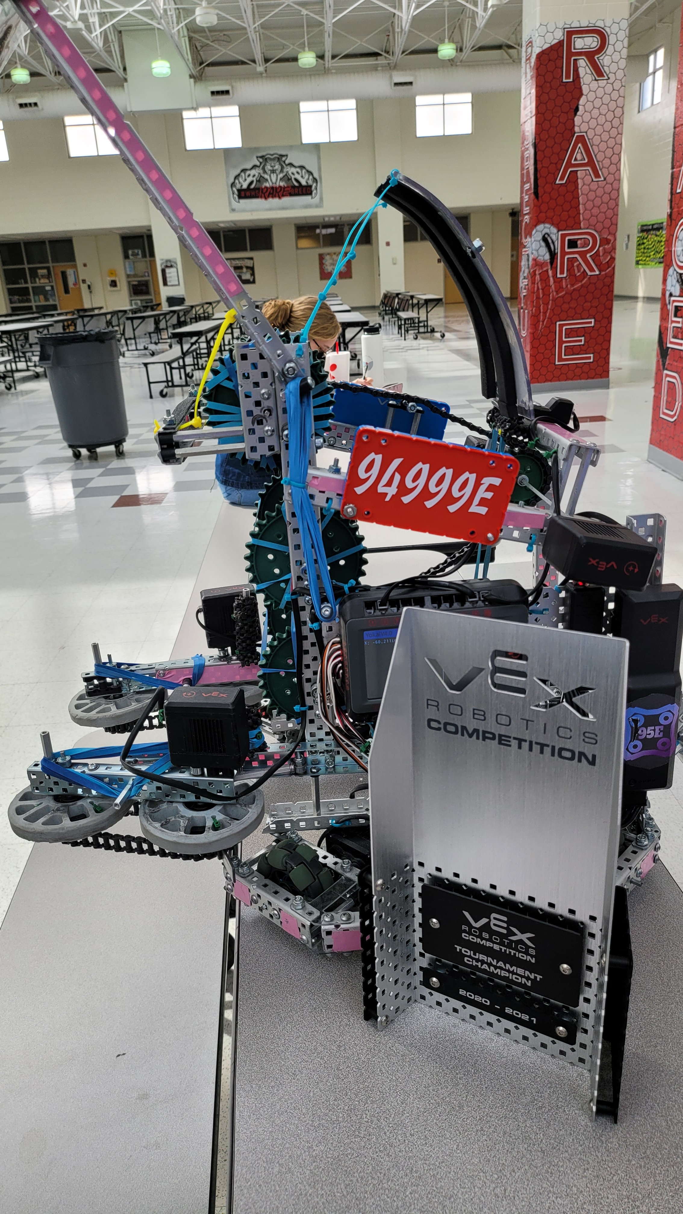

We are proud to present our mid-season robot for Change Up! This bot has been used at two tournaments so far, throwing one and winning the other. We have leared a lot when building and competing with this robot, as we hope to convey below.
About the Bot

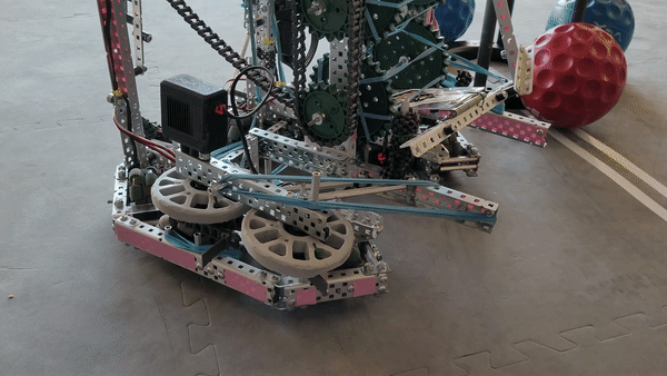

The most notable subsystem on our robot is our intakes. When designing, we wanted something space efficient when folded up, as well as something that would provide even compression on the ball. In the end, we decided to attach the intake using a 4-bar linkage.
As the 4-bar allows for outward movement of the intake at any point, we have even compression on the ball, allowing us to more easily tune the intakes. In addition, we were able to use the movement of the 4-bar linkage for a compact deploy, as shown.
(Old picture from when we still had an ejector)
The main downside of these intakes is increased slop in the joints. Due to the compact nature of the 4-bar, we were unable to use proper screw joints for the 4-bar joints. Because there is nothing bracing the screws in one place, they have a tendency to loosen and become sloppy. While this does not impact the performance of the intakes, it is something we hope to fix in future iterations.
Most other parts of the robot are pretty standard. The backboard is not the cleanest, so we plan on replacing it in the near future. We added a wedge onto the back in hopes of performing better defense, and it does work, my driving just doesn’t utilize it to the fullest extent. We will be removing the wedge as Live Remote Tournaments become more prevalent.
As for why we removed the ejector on the back, we simply did not use it. We figured we would be better off attaching the motor to the indexer, allowing us to run the high speeds we show in the reveal. The rubber band ramp for the balls will likely be replaced by a more efficient surface, plastic, later in the season.
One issue we noticed in the design this afternoon is the indexer jamming. If the robot gets too close to the goal, the ball will sometimes not go into the indexer, but rather jam it against it and the plastic of the goal. It’s fairly hard to explain, but it is visible in our match videos. We believe this can be fixed by increasing the distance the hard stop is from the robot, so it should not take long to fix.

This is, without doubt, one of the robots I’ve seen this year.
i disagree i havent pressed the vidro yet
Wow! That’s a great robot! Could you post a gif of your intakes flipping out? Thanks!
that 4 bar flipout is actually kinda brained. Way easier to tune compression compared to a normal back flipout
i’ll suggest having a faster intake though (around 600rpm) since it seems like balls jam on the bottom while cycling since its significantly slower than the rollers
They just need a full rebuild of intakes. Is you noticed they didn’t descore from middle and might now have descored at all.
:+1: ezgif-2-b3392fbe99a9
Definitely! That is one of the main changes we will be making in our coming rebuild.

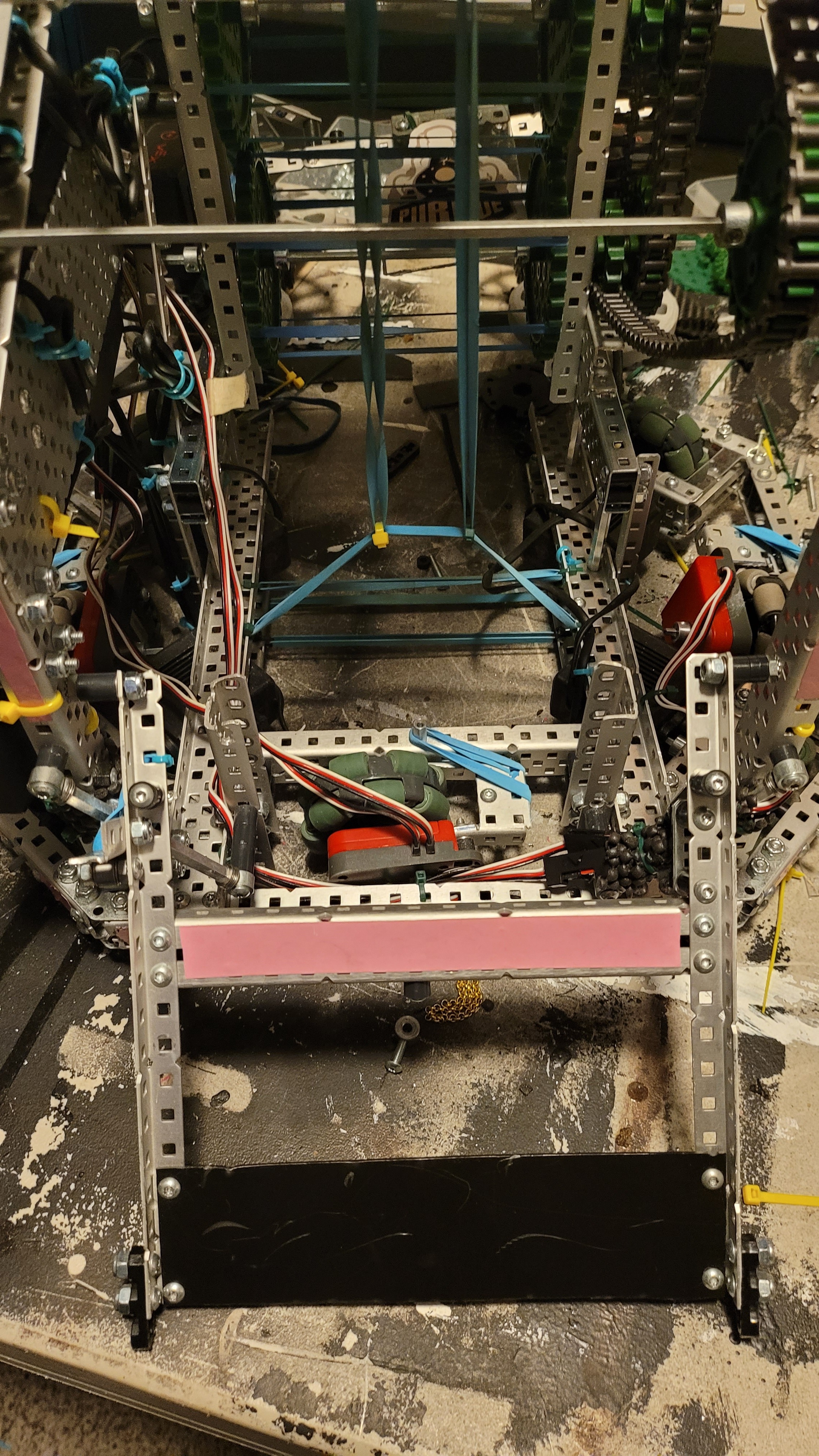

Did you ever tune your backboard. It seemed sometimes the balls didn’t go into the goal smoothly and rolled around. For example in the last piece of footage. I was also wondering if you ever looked into making any sort of wedge for the goals for smoother intaking.
We plan on redoing the backboard when we make other major changes, so fairly soon. You are correct in that it could be much smoother, but it is functional for now.

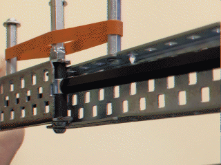

Loved the 4 bar for extending the intakes so much that I had to play with the idea. Maybe you have already considered this, but just to offer a suggestion for when you do rebuild…
As constructed, the 4 bars are a bit flexible when fully extended. This happens (at least on my model) because the 2 standoffs that are two of the bars almost share the same axis when the intakes are extended. This allows them to rotate axially about the joint made my the standoffs, the stand off connectors, and the shaft collar. It introduce some slop that makes your intakes bounce around.
4 bar - single connector
I payed with using 2 standoffs per 4-bar linkage to give the model more rigidity. It’s a tiny bit bulkier, but it very stable. In the gif below, its wouldn’t rotate and is moving only because I couldn’t hold it stable enough.
4 bar - double connector
Anyway, just a quick suggestion to help improve a great idea.
