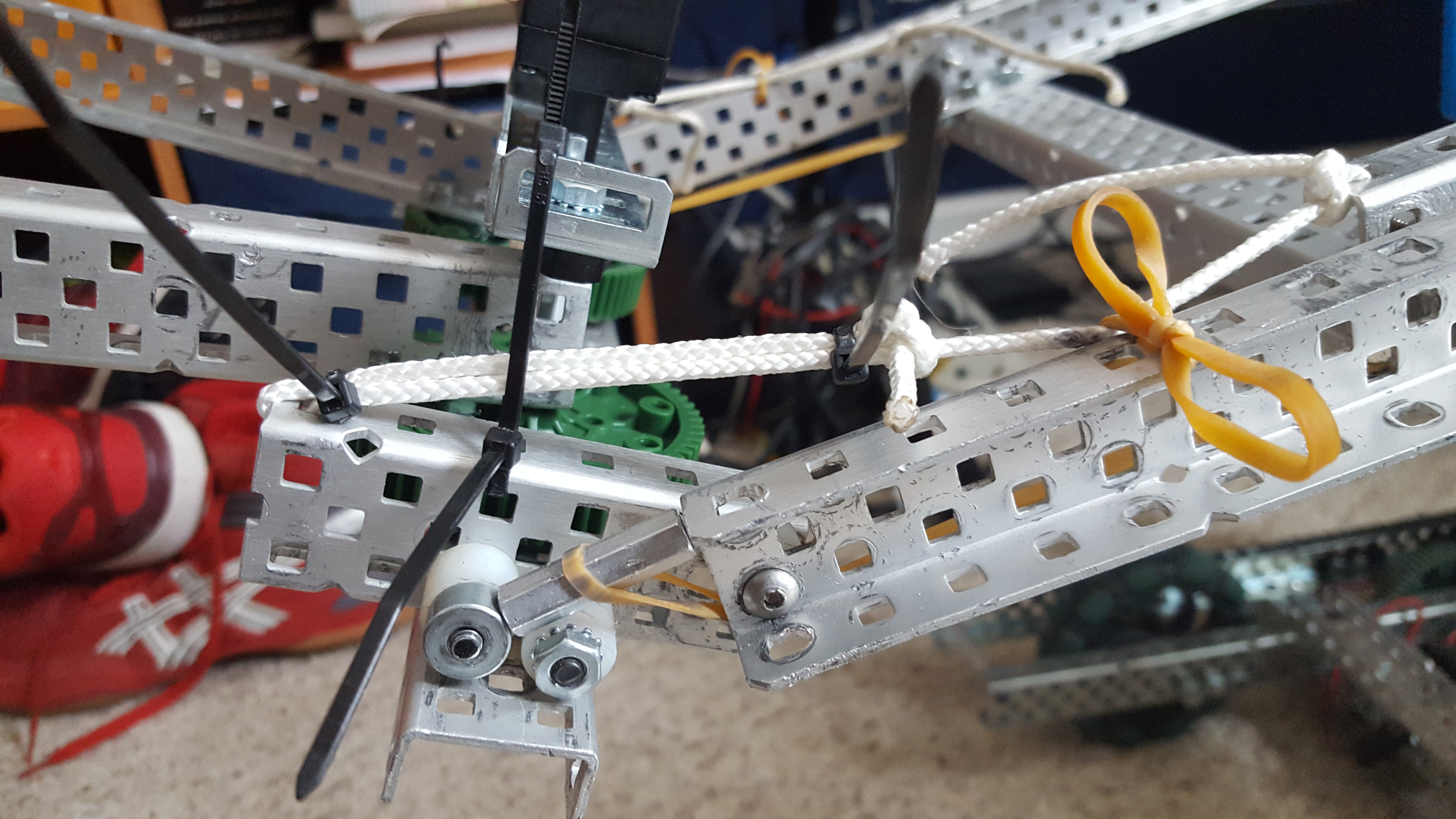

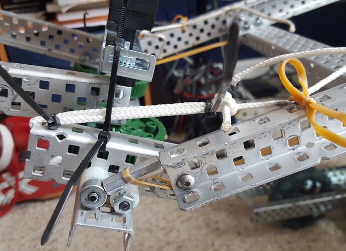

9551B robot reveal.
9551B robot reveal
Specs:
4 motor speed drive 1:1
6 motor speed lift 1:7 (off set 4 bar)
2 motor claw 1:5 (Doesnt work because ports 1 and 10 on cortex dont work)
Anti tiping pegs(Need to be beefed up)
Claw flip out lock(works amazing)
20161231_144636
Tell me what i can do better and maybe how not to use ports 1 and 10 to get my claw working. Thank you so much have a great day and happy news year.
I can’t view the video because it says the video is private
i fix that
It looks like your claw arms are really close together in the picture. I think having a wider claw would help a lot. Also, having some sort of tray on the bottom like 62 or 97919 will improve star capacity.
Thanks for the segestion
