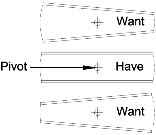

I believe this is something fairly simple, but I am just a novice & are having trouble figuring this out. Hers is my problem. I have 2 plates horizontal and parallel to each other, approximately 6" apart. They share a common pivot point equal distant from the top & bottom as well as left to right. What I’m trying to attempt is to have is to top plate rotate the same degree as the bottom except opposite. In other words. Using the right side as an example, If the lower right plate angles down 10 deg. the top right plate will rotate 10 deg. up. If anyone could help me using gears to have these plates pivot in equal amounts in opposite positive directions. ANY and all help and comments will greatly be appreciated. Thank You. Jerome.

Wow. You want a common pivot point , not axis? And mirrored movement around that point? Sort of a reverse helicopter control rod and swash plate assembly? Crossing (“reversed”) linkages gets complex. Perhaps you need to invent and 3D print 3" hemispherical gears, the “teeth” concentric circles around the common normal pivot… With elastic connection through normal pivot point, like tendons in the middle of our knees… Would need a way to prevent twisting.
What causes one plate to tilt? External force, or does it need to be a motor/servo?
How big are the plates? What material?
Nice drawing.

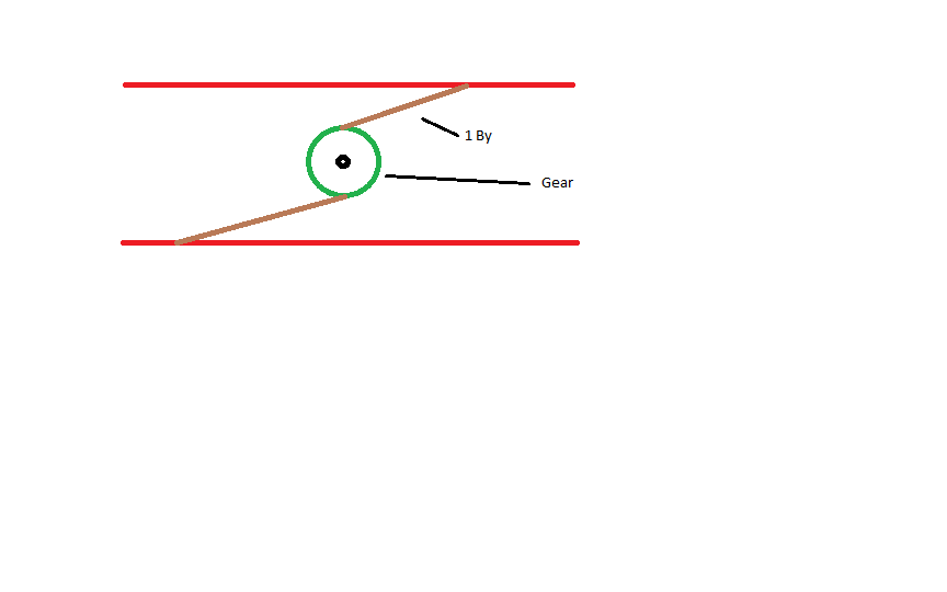

i think you could do something similar to this:
Test
The 1 By’s have joints on them, with one joint on the gear and the other on an arm. The two 1 By’s length will be the exact same so the arms both turn the same amount.

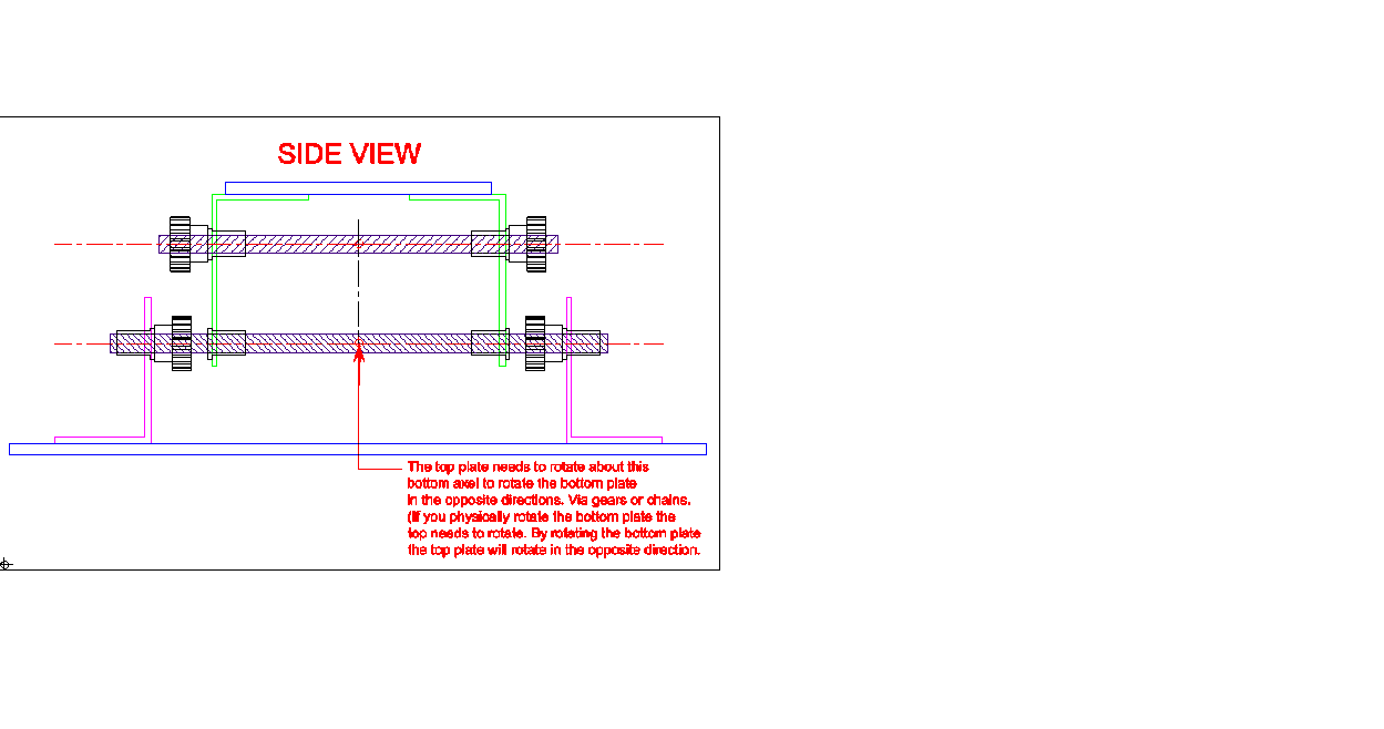

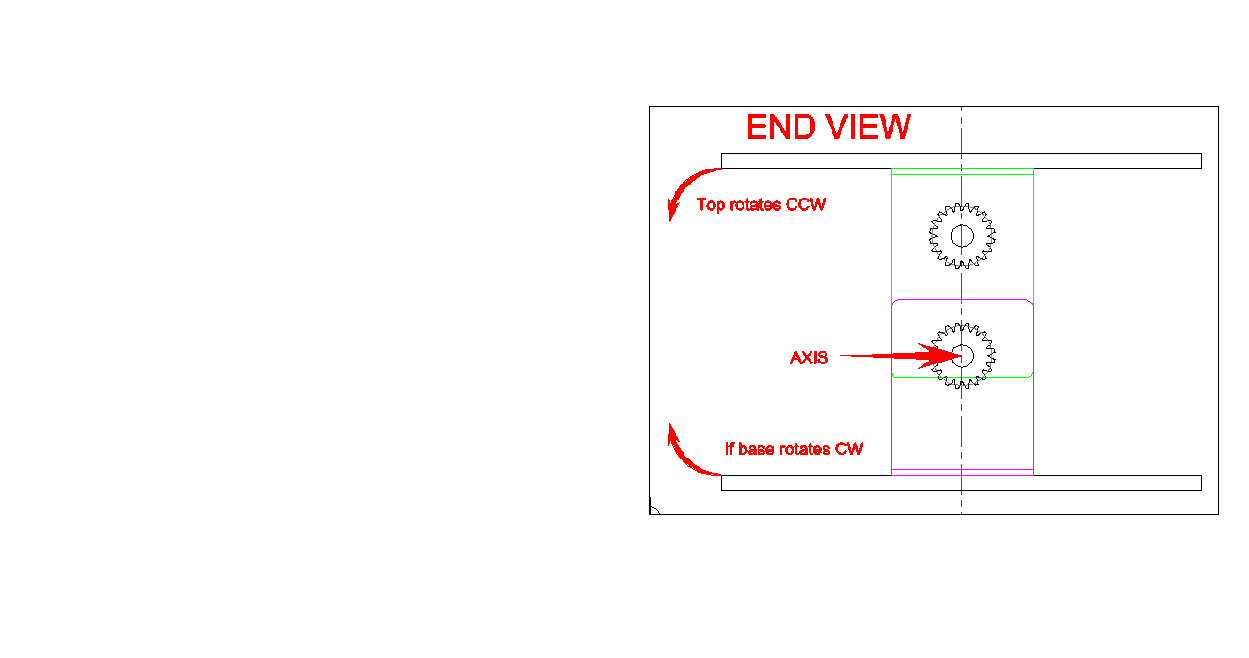

A more detailed sketches of my dilemma. Maybe this additional drawings would help.
#17
Are these drawings your given exercise? Or a partial solution? Questions,
  1. The plates do not seem equidistant from common axis.
  2. Is the lower gear is fixed to the red bracket and the upper gear fixed to the green bracket, or are they free to turn? It seems the intention is all fixed, except green bracket pivots on lower axle.
  3. Movement of both plates would need to be in reference to an external stationary mount point, otherwise the problem is moot.
Is there more info available?

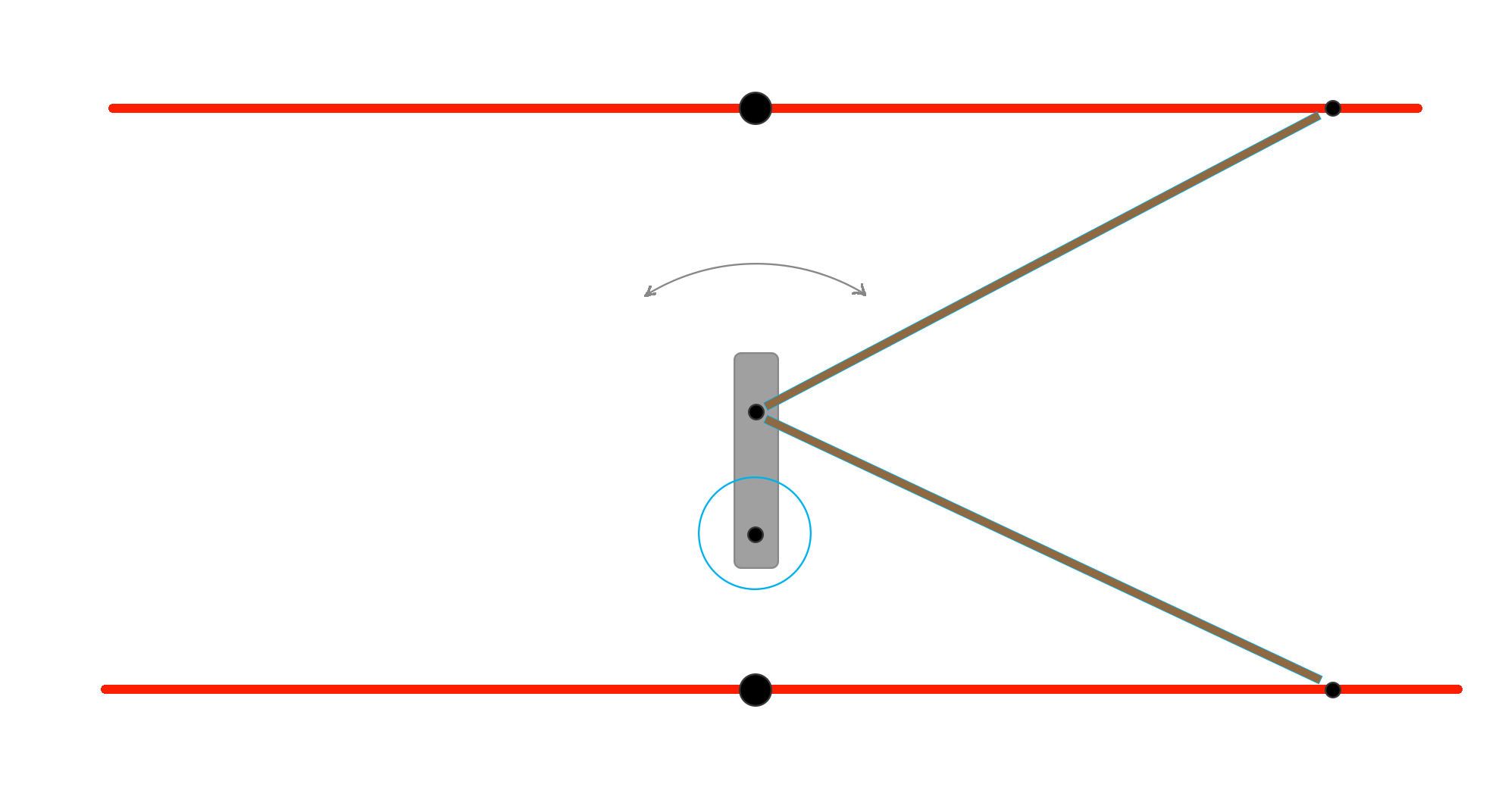

Hey, @ProStreet how many degrees do the plates have to rotate?
What are the forces that you expect on those plates?
If you tell us what you are trying to build at the end it will save a lot of time for everyone.
If you already have something that you need to work, why do you think vex parts are you best choice?

Interesting idea for several uses, but wouldn’t the mechanics be more like this:
Untitled-2-Recovered
Or a linear slide.
I think your sketch will keep the plates parallel as they move.
