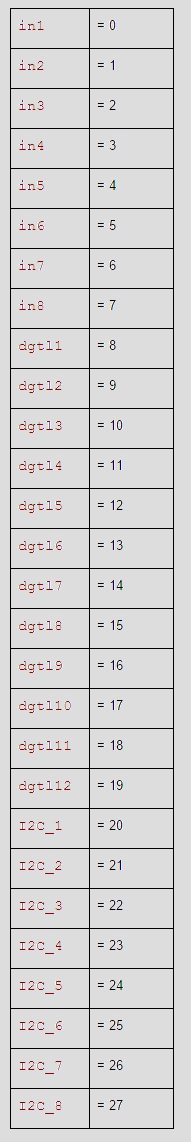

So they have this struct accounting for all gyro variables, and there are user functions directly communicating with that global struct, like this:
void gyroSetPort(int sensorPort)
	gyro.sensorPort = sensorPort;
The gyro.sensorPort is defined in the struct as an integer.
But later in the sample code we see this thing in pre-auton:
gyroSetPort(in1);
So that got me confused: how can you give something like “in1”, which should be a string, to an integer gyro.sensorPort? So you can directly give a string to an integer? And how would the string be interpreted? In this case, if you give “in1” to the integer variable, would the reading be “1”?

So the nuances programming aren’t really my specialty, but it doesn’t look like in1 is being passed as a string because there are no quotes around it, right?
Instead, it looks like they are calling a variable or macro that was probably in the #pragma/#define of the original code this example was cut from. As it sits right now, I don’t think that line would compile correctly because the variable or macro in1 hasn’t been created/defined yet.

in1 is a variable that RobotC recognizes as the analog read port 1 on the cortex. If you were to call the SensorValue() function you could pass in1 as a parameter and it would return the value of a read on analog port 1. I made that parameter in the struct so that you can set the gyro to any of the analog ports in robotC by passing it as the parameter (ie. in1, in2 etc.)

ROBOTC reads the configuration and generates a list of defines most likely.
It probably behind the scenes spits out:
#define in1 1
in your code. Tabor should be able to confirm this (since he kind of has access to the source code atm).
Just found this. It has everything you appear to be looking for if you needed to know specific values. http://www.robotc.net/wikiarchive/Data_Types#dataType_tSensors
Thank you. This is exactly what I was looking for. I took a screenshot and pasted it here so everyone can see:
https://vexforum.com/attachment.php?attachmentid=9393&stc=1&d=1433432351

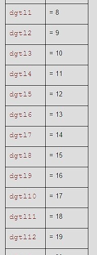

So it turns out that every sensor port is designated an integer number. So you can actually call SensorValue[1] and it would mean the same thing as SensorValue[in2]. Quick experiment: I plugged this thing into ROBOTC and hit compile, no error.
https://vexforum.com/attachment.php?attachmentid=9394&stc=1&d=1433432660
