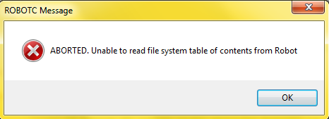

323X has been receiving the following error message. I have never seen it before.
[ATTACH]8194[/ATTACH]
They would download this code:

But it wouldn’t even start the downloading process. It would just freeze for about 15-20sec, then pop that error message up.
Does anyone know what is going on?
They have re-downloaded all the firmwares, and they are using ROBOTC v3.62.

Are you sure everything’s been wiped and reflashed? It’s nothing wrong with the code. The flash memory in your cortex is messed up.
Make sure you’ve wiped everything. If that doesn’t work, then I guess it’s time to RMA.

Has the ROBOTC firmware been correctly loaded? This message usually happens when something like a master firmware upgrade is done and then the ROBOTC firmware not loaded.
The most likely cause of this problem is (prioritized)
Human error
Problem with the PC
Problem with the download cable
problem with the cortex

I’ll re-download both again just to make sure. I will try both programming cables as well.
Try resetting the ifi firmware with the firmware upgrade utility. do this on the cortex and the joystick. then redo the robot c firmware. That usually works for us. Also, if that doesn’t work, re install robot c or try it on a different computer.
Check it out. It works now.
I feel like they forgot to update the ROBOTC firmware, they just did the master firmware yesterday.
Now I know whenever I see that message, try re-downloading all the firmware.
I still need to get an RMA for one of the cortex though
Thank you all for your help!
