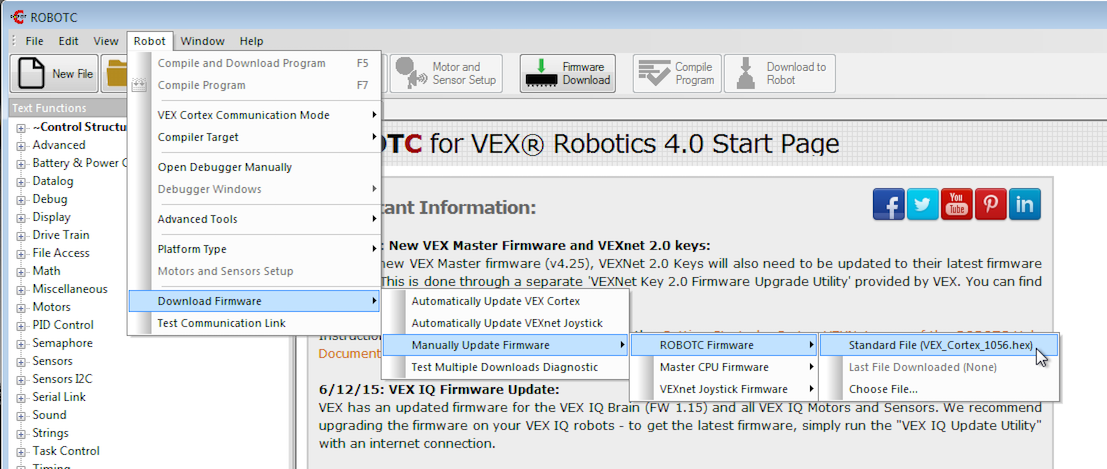

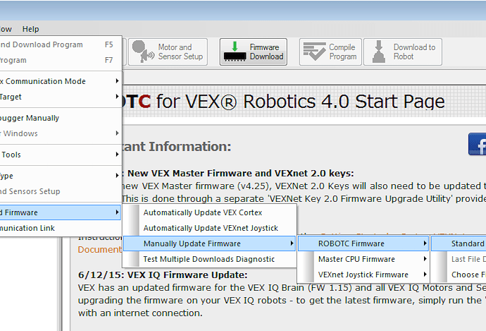

Ok, this implies you have not installed the ROBOTC firmware in the cortex.
The best way to do that is manually selecting the file as shown in this screen shot.
