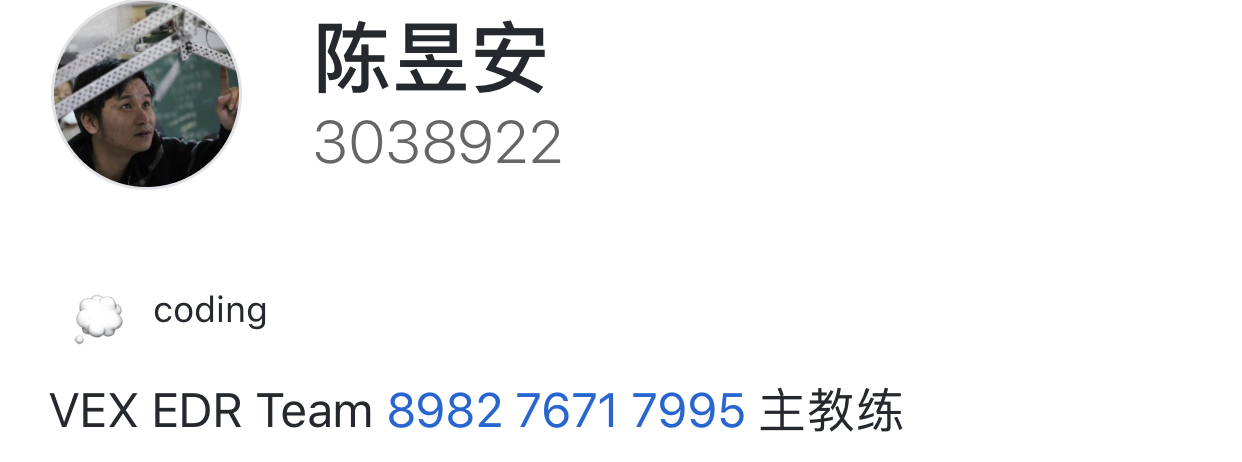

According the github contributor which has the same handle as the vex forum account, it states that you are the “Head Coach of team 8982, 7671, 7995”, so you’re probably the mentor of these teams.
My main concern is that, why is a mentor helping students design a full blown programming library? According to your post history i see a lot of examples of you personally programming for students, rather than assisting your students on how to program. Even in this post you’re using wordings like “I will” and “I try to”
Isn’t this a violation of vex’s “Student Centered Policy”?
