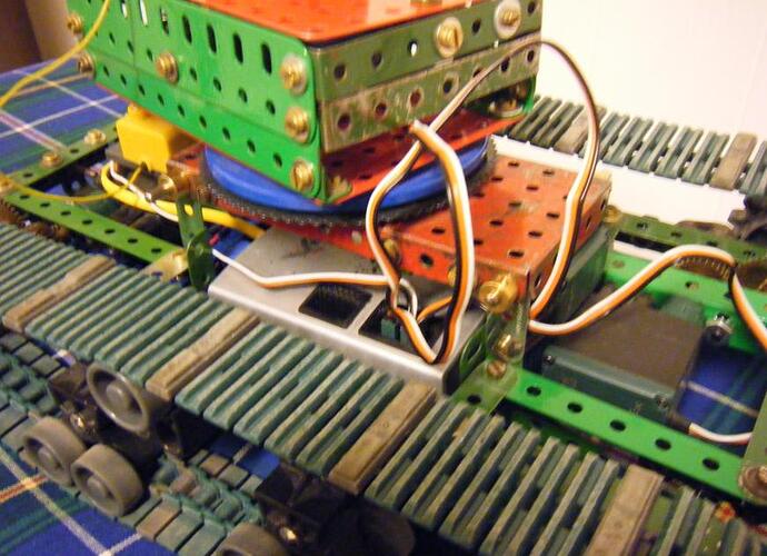

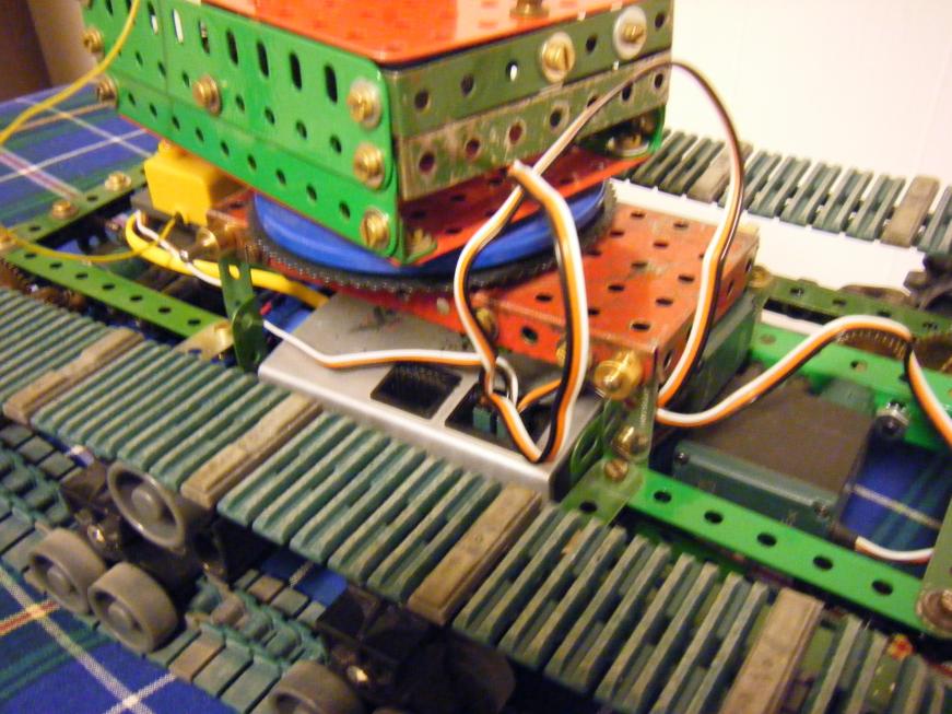

I have been showing an army tank model (pic attached) to kids at shows for a few years. The tank is a hybrid of Meccano and Vex. Kids, even very young (around 3 and up) ones, like to drive the tank using the Vex 6 channel transmitter. They seem to have educated thumbs these days at a very early age.
I am now building a six wheeled armored car along the same lines. What is the best way to remote control Ackerman (the most common) type steering? I was thinking of using a Vex servo motor like I used for the tank turret and gun, but three positions are really not enough for wheeled vehicle steering. Is there a different Vex (or compatible) transmitter with a steering wheel as well as a few levers? Then I could use a regular Vex motor.

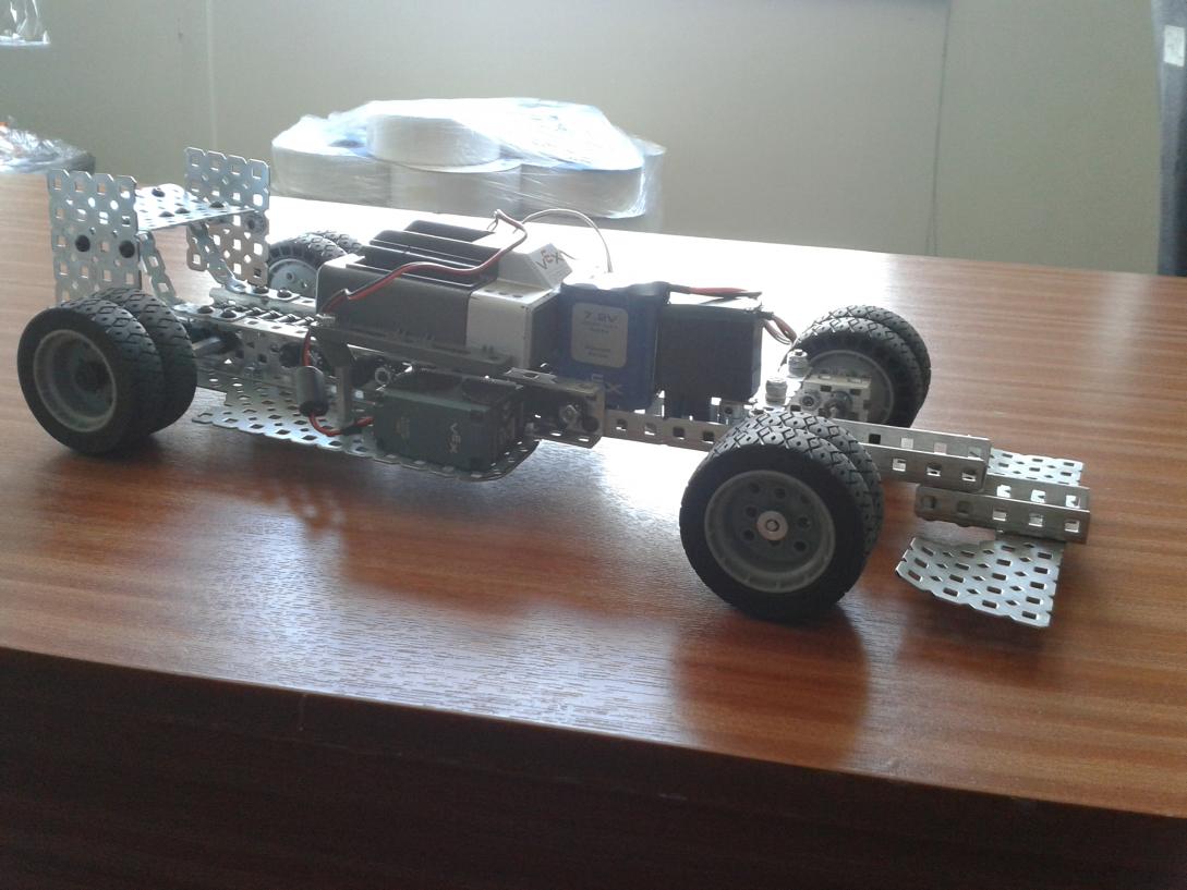

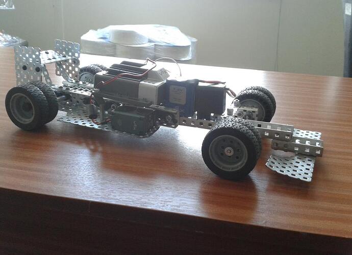

Interested in this as well. I build an F1 car for an event we did which has pushrod steering using a VEX servo but not Ackerman geometry.
No suspension either which makes things easier.
I’m going to be doing a VEX IQ 4x4 vehicle using the new IQ differentials and a transfer box when I get a chance this year. The idea being that 2 or 3 motors in the front of the vehicle will drive all 4 wheels with a differential on each axle.
The problem I am having with this is designing small ball joints using IQ parts so that the steering arms have movement when the wishbones rise and fall. I am trying to do it with 100% IQ parts but I am thinking I may need to 3D print the ball joints for where the steering arm meets the suspension hubs.
