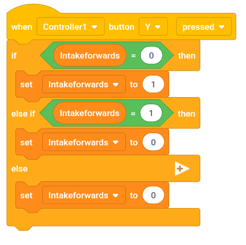

Hello, I want to activate and deactivate a function with a single button but I’m new to programming and I’m just learning it on my own but this is getting complicated
You could do something like: make a variable that changes by 1 when you click the button, and when the variable is greater than 1, set the variable to 0. Now, put an if statement where if the variable is 1, do the action; if it is 0, don’t do anything.
Note: I am not a professional coder, I am just trying to give a simple solution, although there might be better solutions.
Screenshot_20221116-205524_kindlephoto-34365636
Then use forever loops to run things when the variable is a certain thing or put things inside the loop like simple start or stop motors

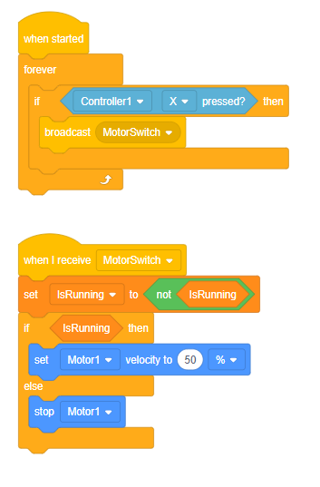

I’ll plug my post. The example uses a bumper switch but that could easily be a button.
Isn’t there a code block that differentiates between a button that’s just been pressed (single event) and a button’s that’s held down (continuing event)???
You can create events with the Broadcast element. I believe that it is a “once per press” but I have not personally tested it.
Which codes the following:
bool IsRunning;
event MotorSwitch = event();
int whenStarted1() {
  while (true) {
    if (Controller1.ButtonX.pressing()) {
      MotorSwitch.broadcast();
  wait(5, msec);
  return 0;
void onevent_MotorSwitch_0() {
  IsRunning = !IsRunning;
  if (IsRunning) {
    Motor1.setVelocity(50.0, percent);
  else {
    Motor1.stop();
int main() {
  // register event handlers
  MotorSwitch(onevent_MotorSwitch_0);
  wait(15, msec);
  whenStarted1();
