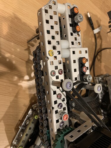

What I run:
600 RPM
2:1 gear ratio (Using sprockets)
2 inch intake rollers
1 rubber band that is barely stretched
Is what I have on my ratchet intakes. They burn out in about 5 mins so kinda annoying to use while practicing but if you have them on quick swap it shouldn’t be a problem.
You mostly have to optimize the ratchet. Current it barely moves when I spin the intakes for intaking and no slippage while flipping out.

I would like to see what your intakes look like. Here are mine:
or just use a 12t gear meshing with a 36t gear? that’s a 1:3 ratio there that’s only 4 holes long and 3 holes wide. which is smaller than chain, probably lighter, and has no risk of breaking.

also your picture looks like the actual actuating mechanism is a 1:1 ratio, since you have your ratchet direct driven. your chain ratio is only effecting your intake roller ratio, not the actual actuating ratio.
Yea, It’s a 600 rpm ratchet with a 2:1 ratio to the intake rollers. Running an external ratio from the motor to the ratchet it unnecessary since 200 rpm can easily ratchet an intake. (Even A bit too fast) Then I optimized the arm to be as light as possible so I could run a 600 rpm directly to the ratchet.
really, a 600 rpm motor can direct drive the intake actuation? is your banding like super light or something? I wouldn’t have expected that to work, but it’s cool that it does for you.
Well yeah, from the picture the banding is light enough that the intakes probably aren’t able to descore from a tighter goal. If all the goals at a comp are loose, you’re good!
