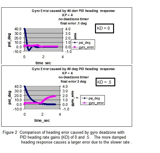

Adding a timed deadzone to the gyro helps minimize errors
When performing slow turns, the heading rate response can remain below the gyro deadzone for periods of many seconds. During this period, the gyro angle is not accumulating the true turn rate and the error is equal to amount the robot turned during this period. (i.e. the area under the heading rate curve).
The gyro deadzone is hidden from the user but is set by a
#define nGyroJitterRange 4
which places its value at 2.8 degs/sec. The time spent below this rate multiplied by the average rate is the heading error. If the rate response is exponential… then the error is tau2.8 deg/sec where tau is the time constant of the response.
I.e. I use a PID way point tracker which commands a heading response with a tau = 1 second. The rate can be modeled as 100 deg/sec
exp(-time/tau). The area under the tail when the rate gets below the deadzone is 2.8 degs. So this error occurs for every turn and is cumulative if the turns are in the same direction.
Edit: One way to minimize this error is to delay the deadzone until the turn is finished. For an exponential turn rate response this is about 3 time constants to get about 99% of the rate response included. For a tau = 1 sec this is 3 seconds.
Since the deadzone is delayed for 3 seconds gyro drift due to noise can occur. For a typical drift rate of .1 deg/sec we can pick up a .3 deg error which would not have been there if the deadzone were active. So this is the trade off…the net savings makes it worth while.

Team80 asked me to show some of my simulation results. Here is a response comparison with and without the timed deadzone on a typical waypoint steering heading response. The curves show and improvement from 3.2 degrees to .3 degrees with a 3 second timer added. The error is almost zero with a 4 second timer.
https://vexforum.com/attachment.php?attachmentid=7362&stc=1&d=1364946157
Just for fun, I also added a typical PID heading loop response with different KD rate gains that cause the response to be more of less damped. With no rate feedback, the response overshoots and settles quickly causing only a small error. With the more damped response the error gets to about 2 degs. Again these are just simulated responses but they give you an idea about what happens if you use a highly damped heading response.
These responses have no timer.
https://vexforum.com/attachment.php?attachmentid=7363&stc=1&d=1364949757
