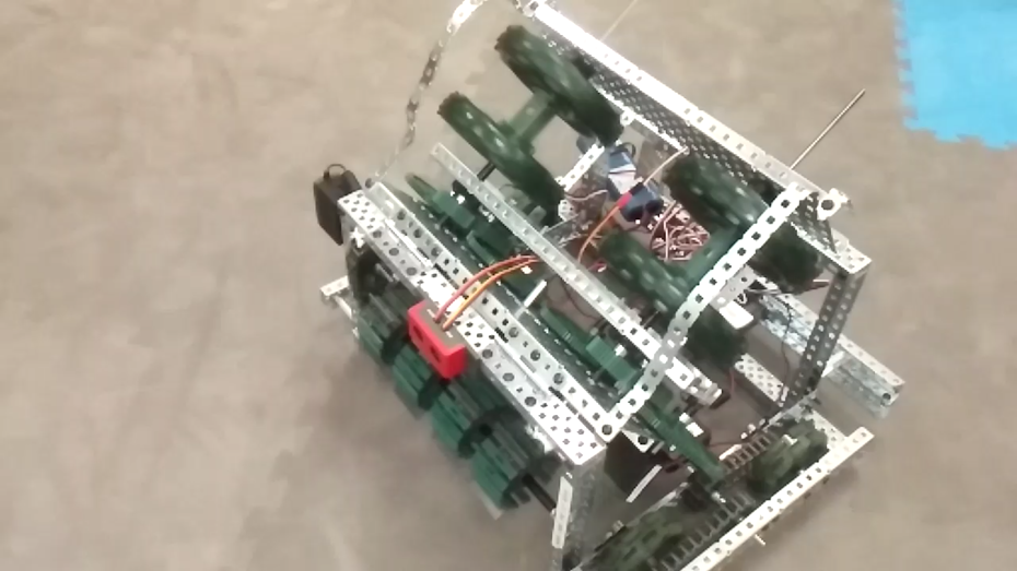

Adding acceleration to my motors [Help]
The launcher on our robot currently has 4 motors on it for the 4 flywheels and I’m worried that suddenly ramping the motors for it up to 127 might damage them or the robot. I’m worried about the drive motors too especially because we have a 4 wheel drive omni robot only controlled by two motors (and our bots getting pretty heavy). I’m attempting to add acceleration to all these motors but I just can’t get it to work. Here is what I have now

The idea is the motor equals launchspeed and each time the while loop completes which should be every two tenths of a second the launchspeed has the increment added to it. Right now, however, It dosen’t do anything at all. The drive motors work fine.
This isn’t the final code for our actual competition bot but for the test bot I have at home. Any help would be greatly appreciated.

Well it seems I’ll have to go with the system we have now which includes not being so hard on the drive motors as best we can and the code I have now. Here It Is…

During driver control the motors spin at half speed when a button is pressed which allows for shooting goals close up. Then once they have spun up you can press another button and ramp it up to full speed for shooting farther away without damaging it. Also the motors are spread across the breakers in the cortex so they are least likely to trip.
Anyways thanks for helping me even though we couldn’t get it. If any of you get it working post it on this thread so we know later. Until then this is the first time I’ve been the main programmer for our team and I hadn’t really done any programming before this year so let me know what you think of my code above and if you have any suggestions I’d love to hear them. And also I’m attaching a picture of our robot don’t make me regret it. If we show up at a competition and you copied our design were gonna beat you nerds up (It’s not done yet).

Currently reverse engineering your robot’s design. Cya at Worlds :stuck_out_tongue:
Actually most PID Loops for Flywheel Velocity Control will ramp the motors to 127 before lowering the power to get the correct speed.
Like you, I had the concern of damaging my system if I ramped it up to 127, but this is inevitable if you want to implement forms of Flywheel Velocity Control (PID).
Now, I have a PID Loop for Flywheel Velocity Control (which ramps the motors to full power at the very start), and till now my flywheel system isn’t getting damaged.
That’s neat! I’m hoping I can get away with just ramping the motors up to a certain speed and basically spraying and praying but we’re not certain we want to put the engineering of firing full field in yet but If we do decide to do that I’ll probably have to use some form of PID.
