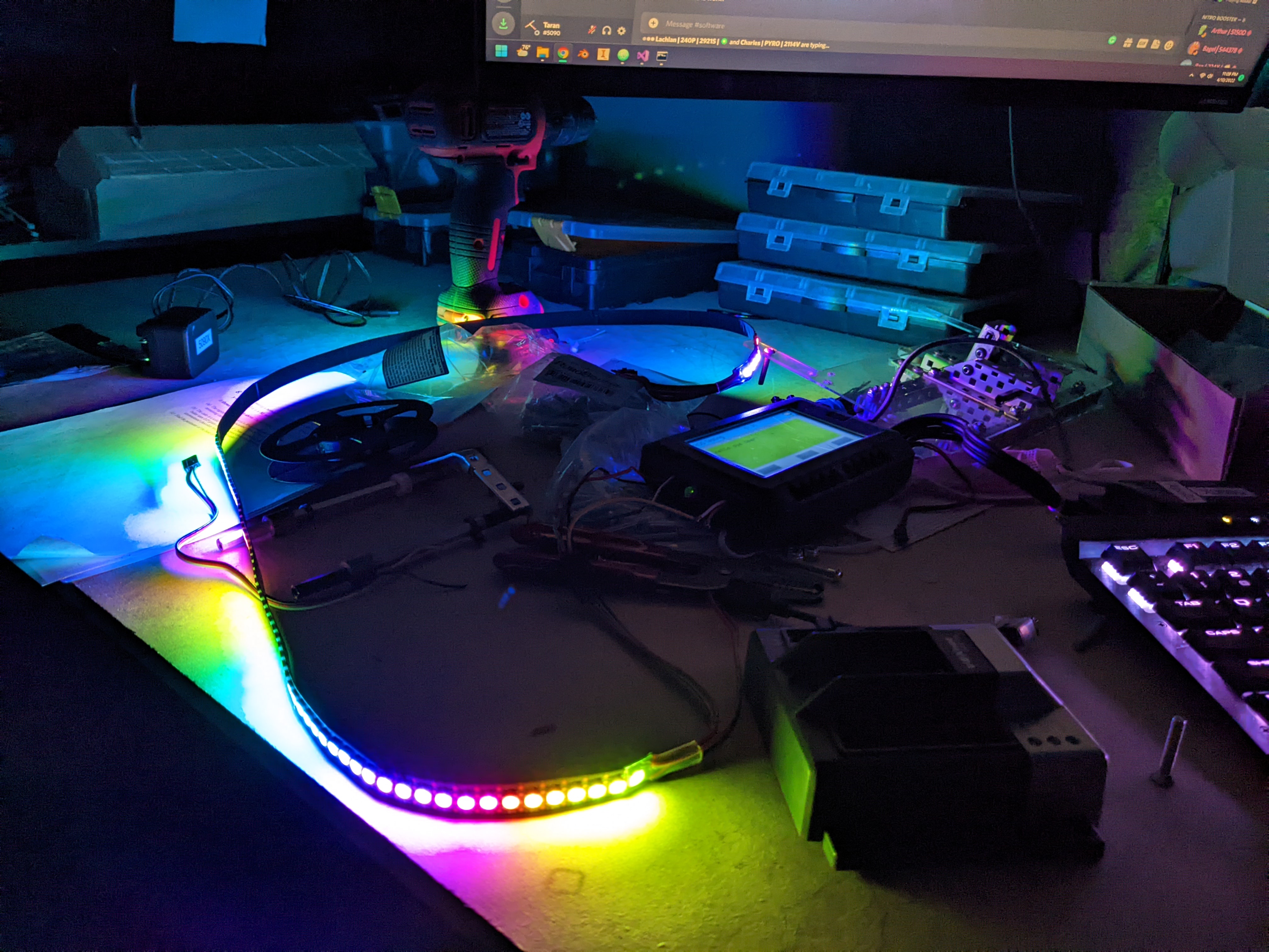

Can you use the v5 brain to control addressable led strip lights? I want to make an led under glow for the upcoming game but external microcontrollers are banned. This means that any led lighting has to be controlled by the brain. The lights will not be functional, I just want to make our bot stand out on the field with a nice pattern always showing. I plan to power the lights externally with a USB battery. The light strips will be ws2812b lights with a logic voltage of 5v.
Yes it’s possible, but due to the slow update rate on the V5 ports (10ms) you will have a very hard time lighting up the entire strip before the match is over.
I have heard rumors that something is (potentially?) in the works to address (haha get it) this, but I’m not positive.
