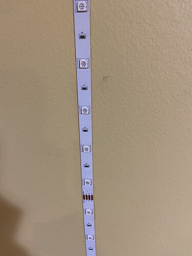

Could you share a picture of your light strips? I’m not sure exactly what you have.
Yeah, here are some pics, Ik it’s not a ton of info but it’s what I have.
image image image

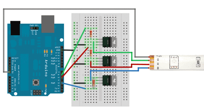

Any chance of a wiring diagram, or anything of the sort?
This is an arduino, but it looks like you should be able to use 3 ports to control the strip. I don’t think you would need a breadboard as long as you send out the right signals from the brain
That kinda makes sense, but how would i wire the 4 ports on the led strip to the 2 prongs of the mc 29?
You use a motor controller for RGB, though I’m not sure how you’d ground it. Also this example needs 12v of power which you couldn’t supply from a brain. You could use 1 motor controller to tell an arduino what color to make the strip display, but that would add some complexity
Edit: See below
You need one Motor Controller 29 for each color channel. Connect the positive outputs of each MC29 to the color channels and any one MC29’s negative output to the ground bus of the LED strip (all the grounds will be tied together anyway).
Note that either output of an MC29 can be the positive output. For simplicity, in your code make sure you only ever drive the MC29s with a positive or zero power level. Determine which output is the ‘positive’ output based on that restriction.
