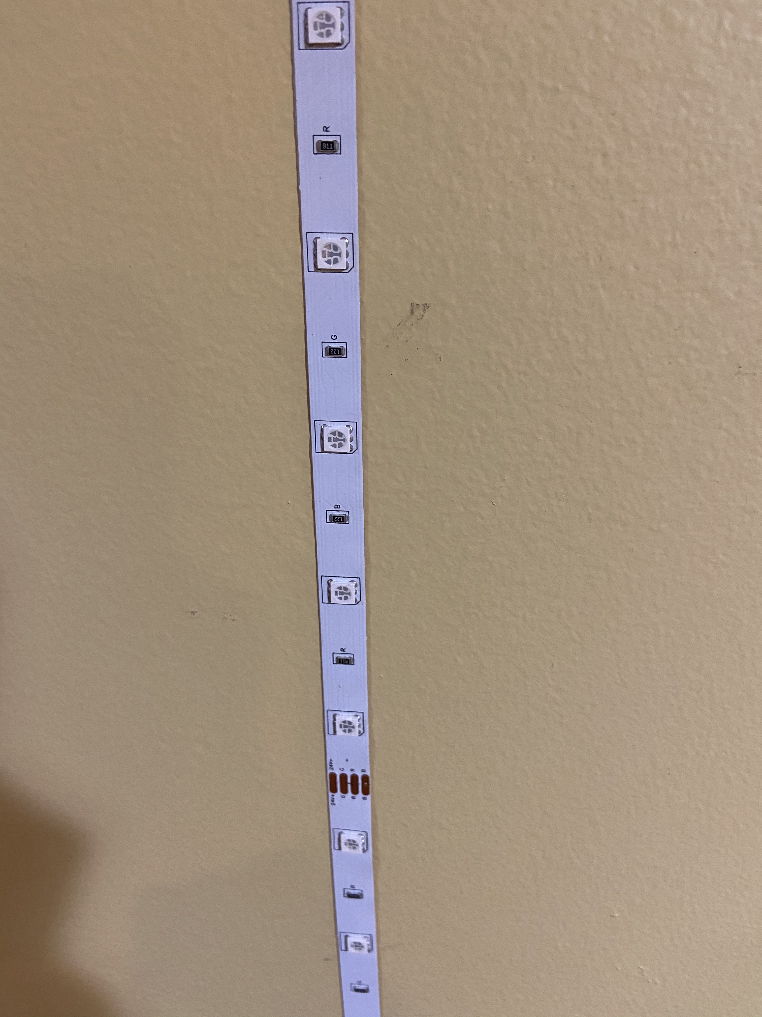

Could you share a picture of your light strips? I’m not sure exactly what you have.
Yeah, here are some pics, Ik it’s not a ton of info but it’s what I have.
image image image

You need one Motor Controller 29 for each color channel. Connect the positive outputs of each MC29 to the color channels and any one MC29’s negative output to the ground bus of the LED strip (all the grounds will be tied together anyway).
Note that either output of an MC29 can be the positive output. For simplicity, in your code make sure you only ever drive the MC29s with a positive or zero power level. Determine which output is the ‘positive’ output based on that restriction.
(Disclaimer: this post is not written like a tutorial and will require basic electronics skills to follow)
Actually… These are 24V LED strips. There is no way you can power them from a V5 Brain.
