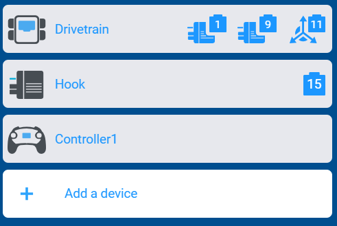

I using the drivetrain function so that autonomous coding is easier, but I also want to be able to adjust the speed of the drivetrain in driver control. If someone can show me how to reference the individual motors in driver control so that I can either adjust the drivetrain speed down or be able to change speed during the match, that would be awesome!
So, I am assuming you are coding in VexCode. When you define the motors for the drivetrain, the first motor you define is called leftMotorA, the second one is leftMotorB, the third is rightMotorA, and the last one is rightMotorB. You can control these indepent of the drivetrain as long as you know what the ports are for each of those.

Here is a basic code with an auton and my device setup.

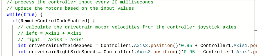

Ok, so up at the top, where you see the # pragma, hit the plus button next to that. From there you should be able to find the spot where it is setting up your drive train drive. if you multiply the axis values by 0.95, that will reduce the speed to 95 percent, and 0.85 is 85 and so on.
Should look something like this

I will give that a shot next period. Thank you! I don’t remember ever seeing the motors themselves as options before today!
This worked to slow down the drivetrain!! Thank you! Can you think of a way to change the decimal during a match? We want to be able to have a fast drivetrain during the first part of the match, but slow it down to 20% when we are trying to balance our robot on top of the platform for tipping point.

More specifically, you could have a variable
double drivetrainMultiplier = 0.95;
and say in the screenshot area from EH-Coder in this post (above)
while (true) {
  if (RemoteControlCodeEnabled) {
    int drivetrainLeftSideSpeed = Controller1.Axis3.position*drivetrainMultiplier;
    // etc.
// And the driver control area
void userControl(void) {
  while (true) {
    if (ButtonA.pressing()) {
      drivetrainMultiplier = 0.2;
    else {
