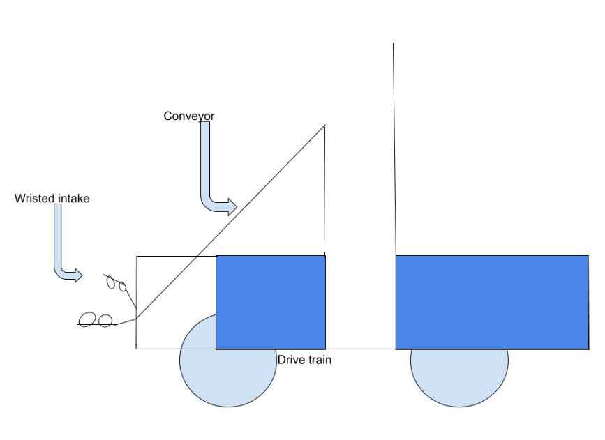

My robotics team is using a roller intake to intake cubes of 2 different sizes. I was wondering how we could make the intake adjustable without the driver having to do much work. Any suggestions!

Pictures would help (of both the robot and the cubes…)

try something similar to pneumatic actuated wheel claws like the ones in power up. This way your claw can adjust to different cube sizes
Maybe try compression intakes. Intakes that perfectly grab the 6" cubes, but as they grab the 8" they open up a bit. Does that make sense?
Sorta. Do you mean compression with the use of a claw or through rollers
Through rollers, all they would need to do is open up one inch on each side.
omni-directional rollers would probably be your best choice as they’ll be able to intake and move up at the same time, and based off your diagram it looks like you’re trying to have them move up your robot, right?
