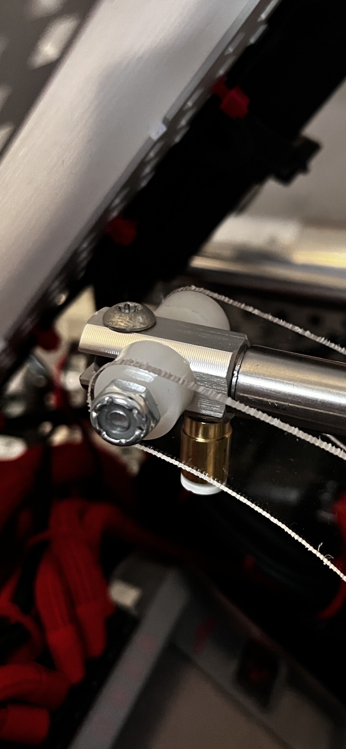

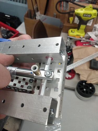

Have you ever had an issue where your air cylinder pivot is the wrong direction? Here is a hack from VEX-U team MCCC:
Take a stand off, at least one inch long, and grind it until it fits into the end of the air cylinder (we have a little milling machine, but the prototype was made by grinding) then secure this new pivot into your structure with a couple shoulder screws from robosource.net.

Instead of grinding down a standoff, you can just put a spacer on the screw going through the cylinder’s mounting hole and insert a screw into the gap instead
seems like a simpler solution source: matthew 1727B
The air cylinder can freely rotate on the shoulder screws. Nothing was done to the piston inside the air cylinder: it moves just as always.
