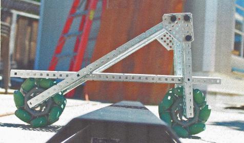

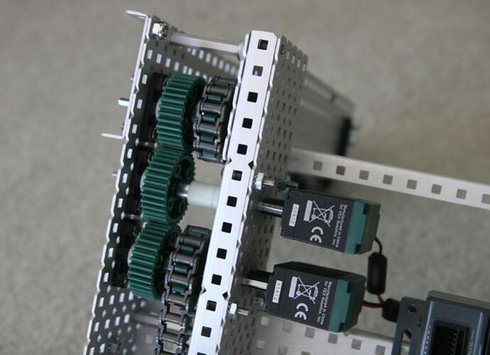

Here’s a prototype I’ve been working on that’s a bit different.

This looks like a great design. There would be a good COG and could get over the bump quite easily.
I would like to see this used on a competition robot, it’s different.
Now it’d be really cool if it had a joint at the top and you could fold up your whole robot to fit it under the 12" barrier in the middle
It does fit under the barrier, just over 11 inches high. Built from 5x25 structure with no cutting required, 17.75 inches long and wide. No idea what an intake would look like yet.
If you would put the cross brace more on one end instead of in the middle, you would have the whole middle area through the opposite end to place an intake, but lose stability in the frame.

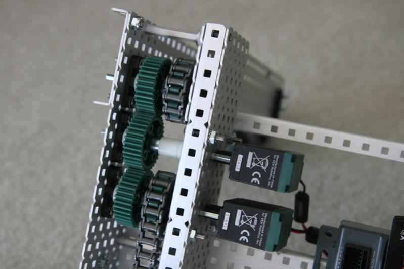

Last year our Z team (not me) did a pretty unique drive system. They decided to really focus on being able to drive over sacks and ended up with this …
They used their plastic allowance to make triangular drive pods and used 4 interconnected single-acting pneumatic pistons per pod to act as shocks (we have a lot of single acting cylinders now :)). Not entirely necessary in my opinion but definitely pretty cool
Driven Robotics, team 1224J I believe, actually used a very similar drive design last year for sack attack with a spatula design. It can definitely drive over sacks very well.

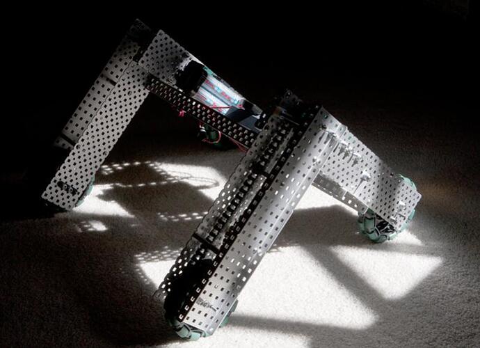

here’s a something similar I’ve tinkered with.
I probably would have used it but it didn’t fit with my lift configuration.
The challenge is to make side C (the horizontal side) flat.

What is that? It looks like half of a Mecanum drive.
It’s a side view, the other two wheels are hiding behind it.
In function (and configuration) it is the same as any other mechenum drive (sort of like Jpearmans). Mechenums have been (in my experience) difficult this year because they lack traction on the bump.
Sorry for the confusion:)
Phillip.
edit:
I just realized that this was an earlier pic when I only had one side of together. my fault

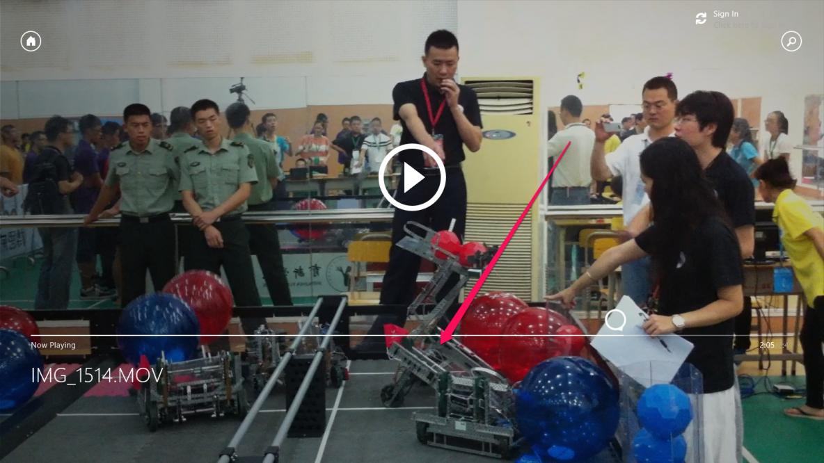

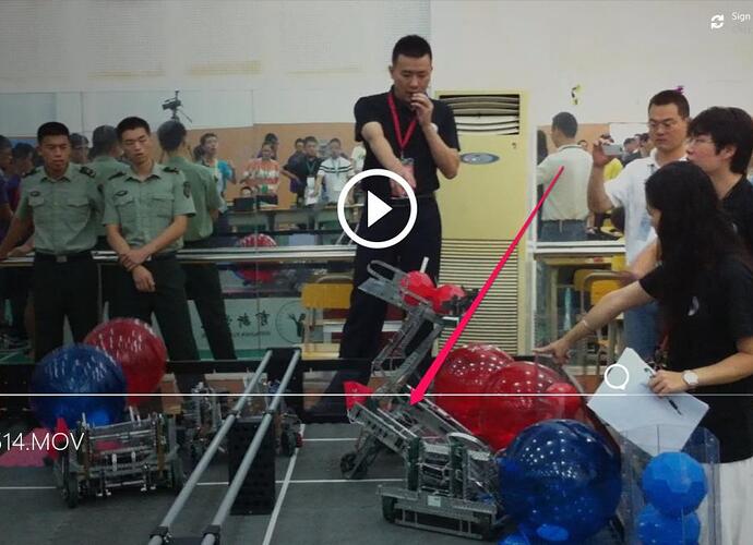

Here is the screen shot form a video. It was in the competition on August, 2013 in China.
The red arrow points to the robot.
Would you mind posting the video? I’d be interested in seeing that at work
Can you post a link for the video?
Hi, Guys.
The file has more than 200 MB and it is quick time format. I don’t have software to edit and change it to smaller file to post on Youtube. Sorry about that.

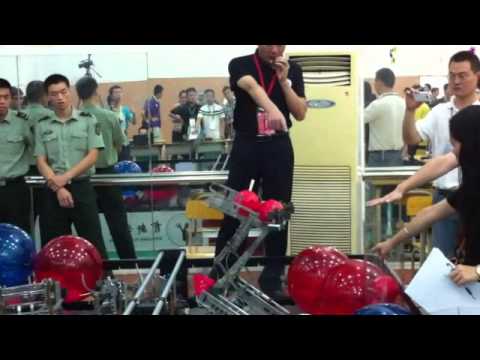

It looks ok and a little bit clumsy. I didn’t see any advantage over others.
I got the video posted
