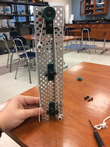

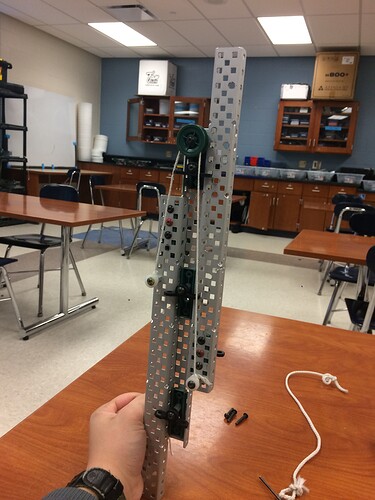

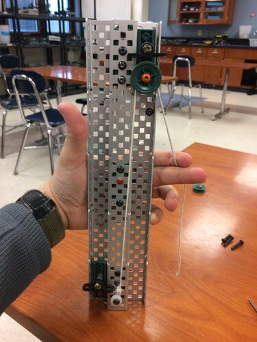

I’ve been out all week, so I’m just now getting to this. Apologies, because I do think I have a good alternative to Dreadnaught.
This cascade uses string, aluminum channels, pulleys, and some other components that can easily vary. (Stops, pillow bearing cases replaced with standoffs connecting both halves of the lift, etc.)
I know there are lots of issues with this design, a big one being that it uses string. Alas, here it is. I know the pros and cons of this design, so nobody really needs to lecture me about why it’s so bad. :wink:

image image image

I have an idea similar to this but it’s much more compact. In order to reduce friction, you probably want to use lexan in some areas where the metal makes contact with other metals. Particularly on the inner part of the c-channel where the “lips” of the metal interconnect (idk if that makes sense)
It makes perfect sense, but the point of that design was to be a proof-of-concept without putting too much work into doing the whole lexan thing.
It uses some basic material coupled with that linear motion kit for those who want to adjust for the weight of the slide tracks (which is what I thought the thread was about). The pulleys can just be basic standoffs or screws, and it’s not a real high barrier design.
Perfect? No. Functional/effective? Yes. But it does have obvious flaws.
I really like this idea. Thanks. I do have one question however. the string is not necessary for the linear motion, correct? As I understand it, the string only provides a mechanism for driving this contraption, which I am actually not intending to do for my linear slides.

Correct. The string and pulleys are just to power it.
Also: Dreadnaught did some crazy stuff to get friction minimal. It might not be necessary to go as far as they did with laser-cut spacers and all. But there is slop in my design that might be fixable with spacing, however kind of unnecessary in such a passive system as I’m imagining you’re shooting for.
