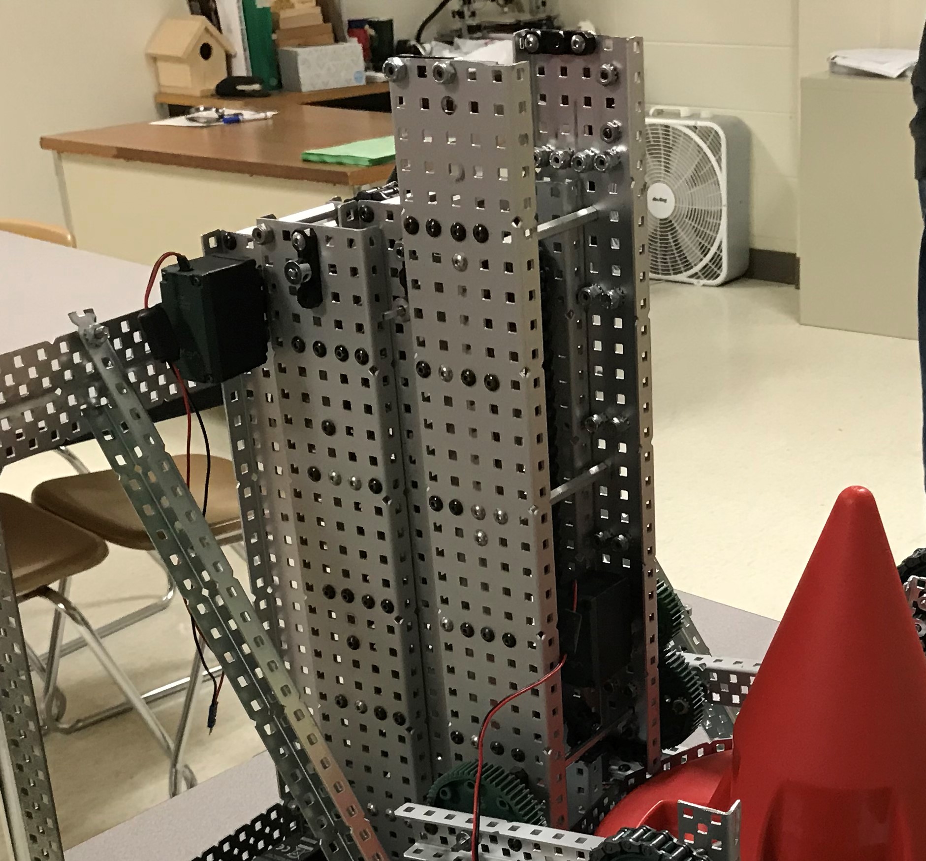

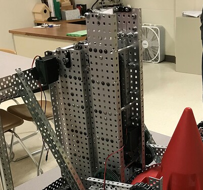

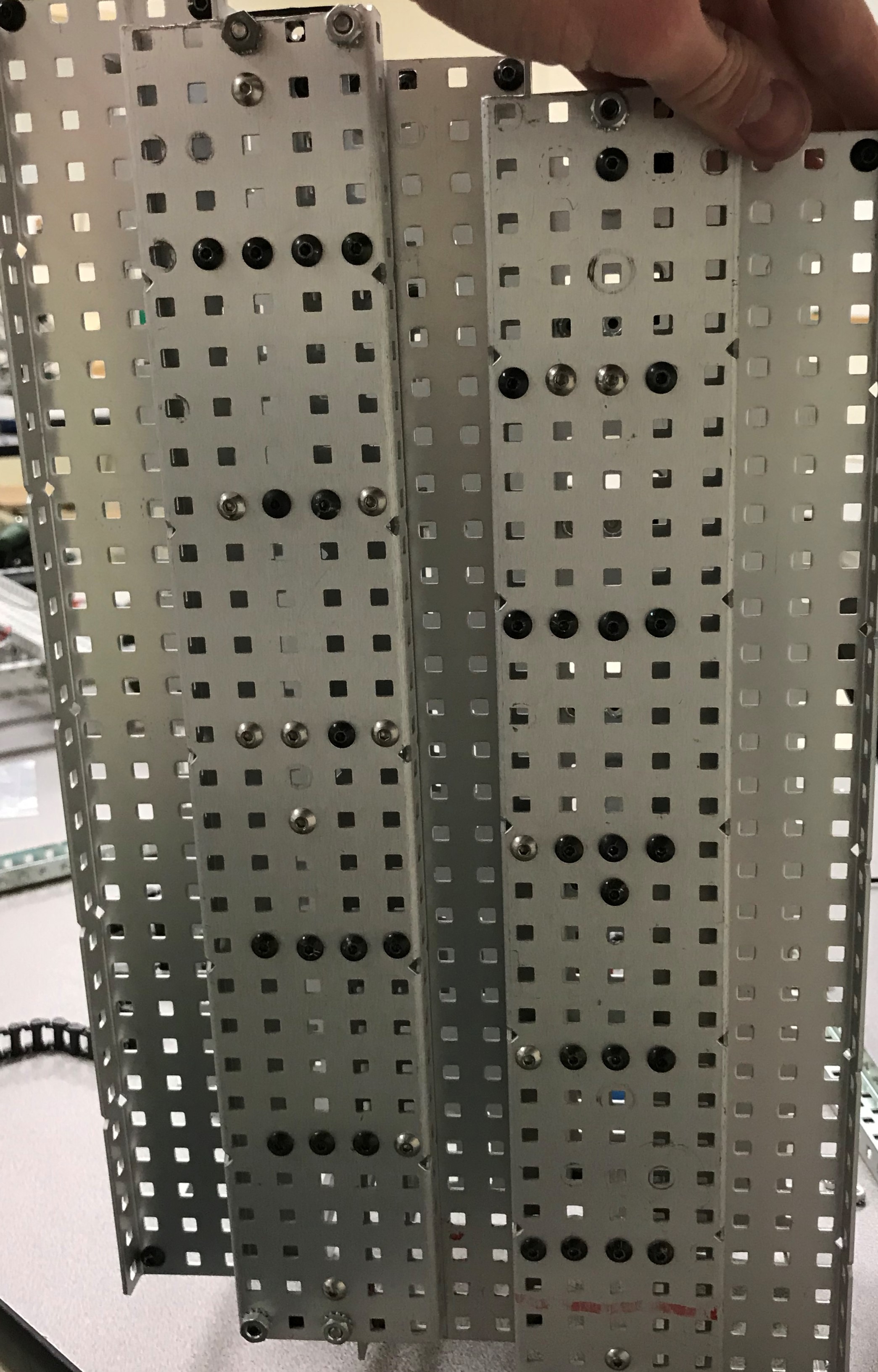

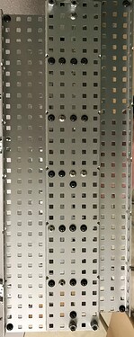

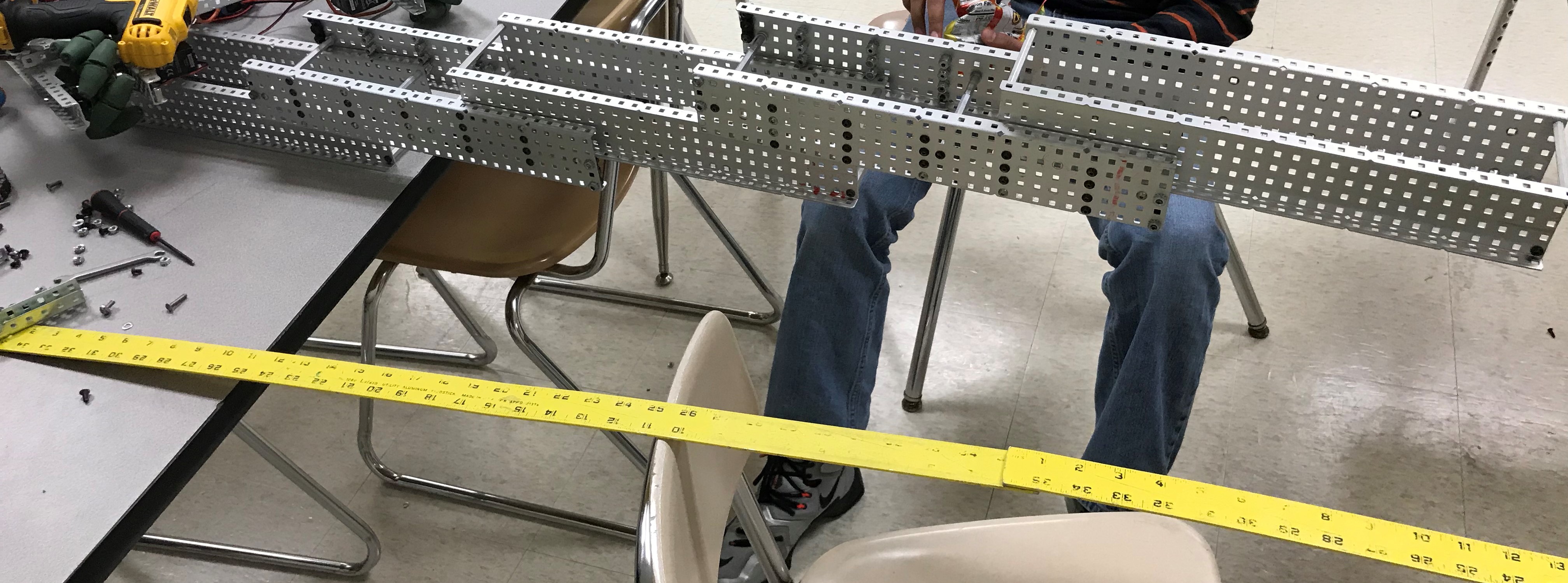

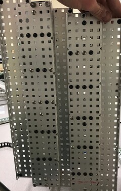

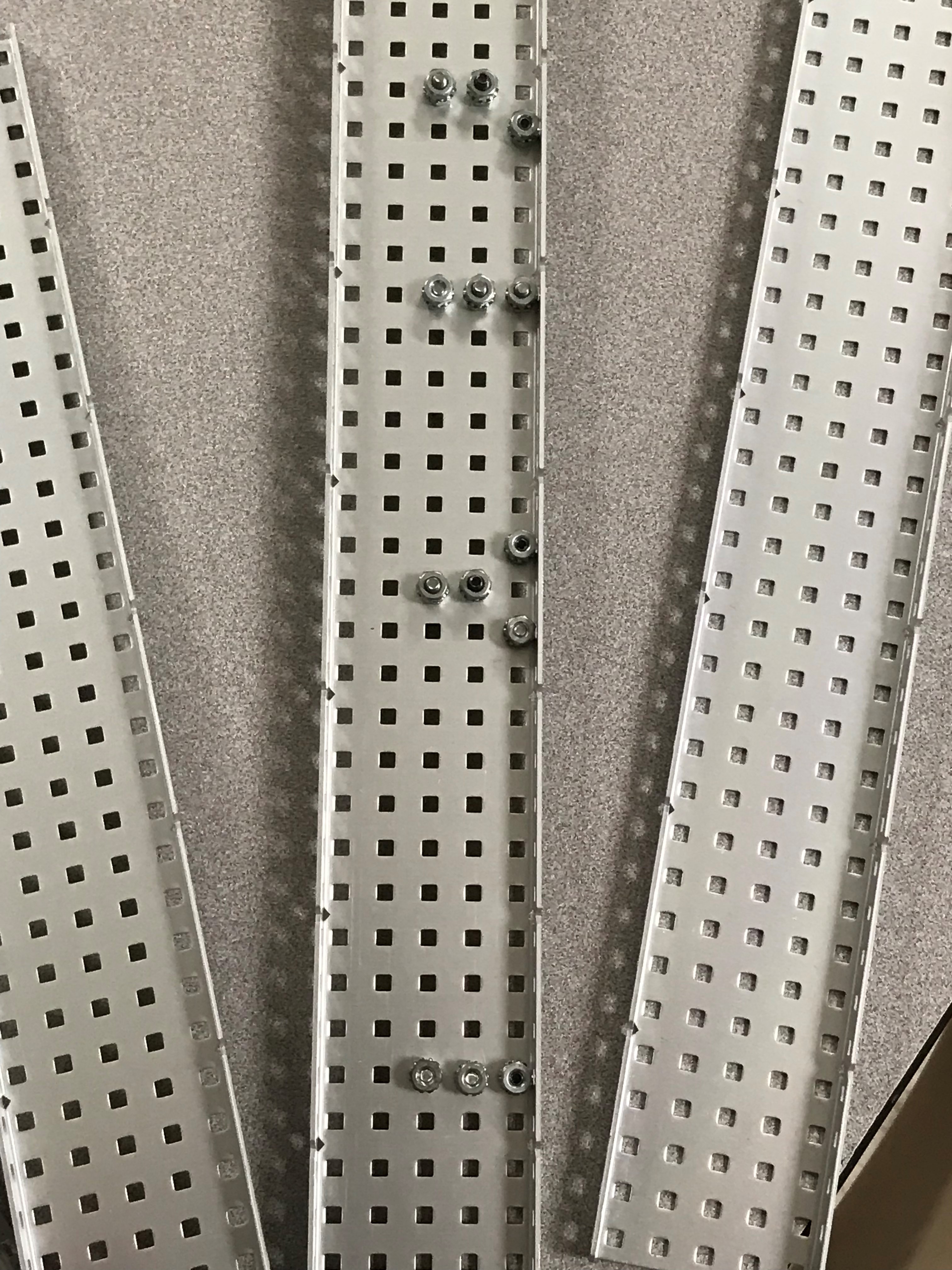

Here are some (pre-Dreadnought) pictures of my cascade from a couple of years ago (2017). The design is much simpler than Dreadnought’s and works just as well. In addition, you should be able to lift it with 4 393 motors or 2 V5 motors.
you used locknuts as bushings?
I am not one who worries much about the weight, but I doubt that it can lift that effectively with lots of extra weight from 5x35s and all of the nuts.
Im not sure that using 5x’s instead of 3x’s is beneficial to the OP’s question which was how to make linear slides that are lightweight and smaller to fit on a claw.
