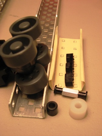

Also attached are a couple collections of vex parts that might make slides.
slide_roller2.jpg shows that tank rollers are slightly too large for 1x2x1 channel.
  • also, a couple shoulder bolts in a short threaded hex might make a good axle for the right sized spacers.
  • and a manilla folded 1x2x1 model showing the edges crimped in.
  • the flat bearing in the middle represents the sketchup piece, some kind of plastic holder to hold several hexbars in a row.

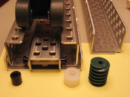

slide_roller1.jpg shows ideas for other types of roller slides:
  • on the right, 2x2 angles have taller edges to be crimped over.
  • on the left, use two 1x2x1 channels nested in a 1x5x1 for the guide
    and a 1x2x1 channel as the slider-roller-carrier.
  • 7/8" hex nests inside, holds shoulder bolts.
  • spacers, worm gears, or winch pulleys might make good rollers
  • tank tread bogey rollers are 1/16" too large, unfortunately.
