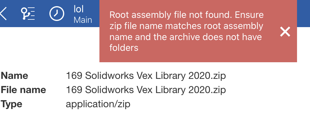

An issue with importing files in Onshape
I’m not sure what to do, the files in Onshape from the 169 parts library it won’t open. What do I do?
Might sound silly, but I’d ensure that the zip file name matches root assembly name and the archive does not have folders. (If that doesn’t work, try redownloading the library.)
