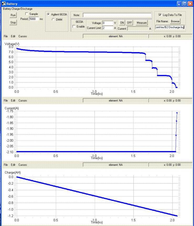

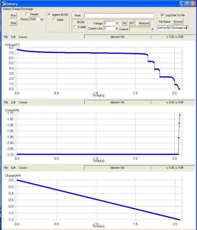

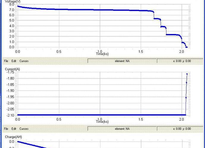

Here is one of the initial discharge plot of your battery at 2A. Note the capacity was only about 1AH but it is old and may not have been charged all the way.
Note you can see the steps where the voltage drops. Each step is one of the cells running out of charge. In general is is not good to keep discharging a battery after a cell is dead because it gets reverse voltage across it. However I wanted to see just how balanced the cells were and to do it this one time will not hurt the batteries too much. As you can see that the weakest battery had about 25% less capacity than the strongest one.

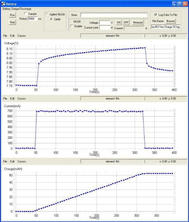

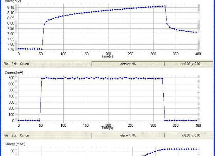

This next plot shows a the Vex charger properly charging the battery:

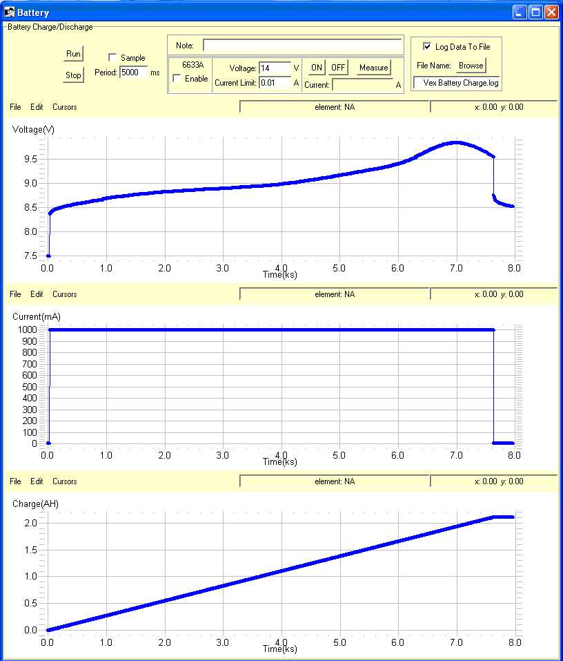

This plot shows what the Vex charger was doing for us when the switch was not engaged:
