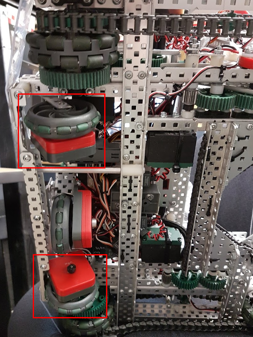

As a practical example, last year, we used unpowered wheels for angle (and position) tracking, and they were omni wheels far behind the turning center (and center of mass) of the robot as seen below.
