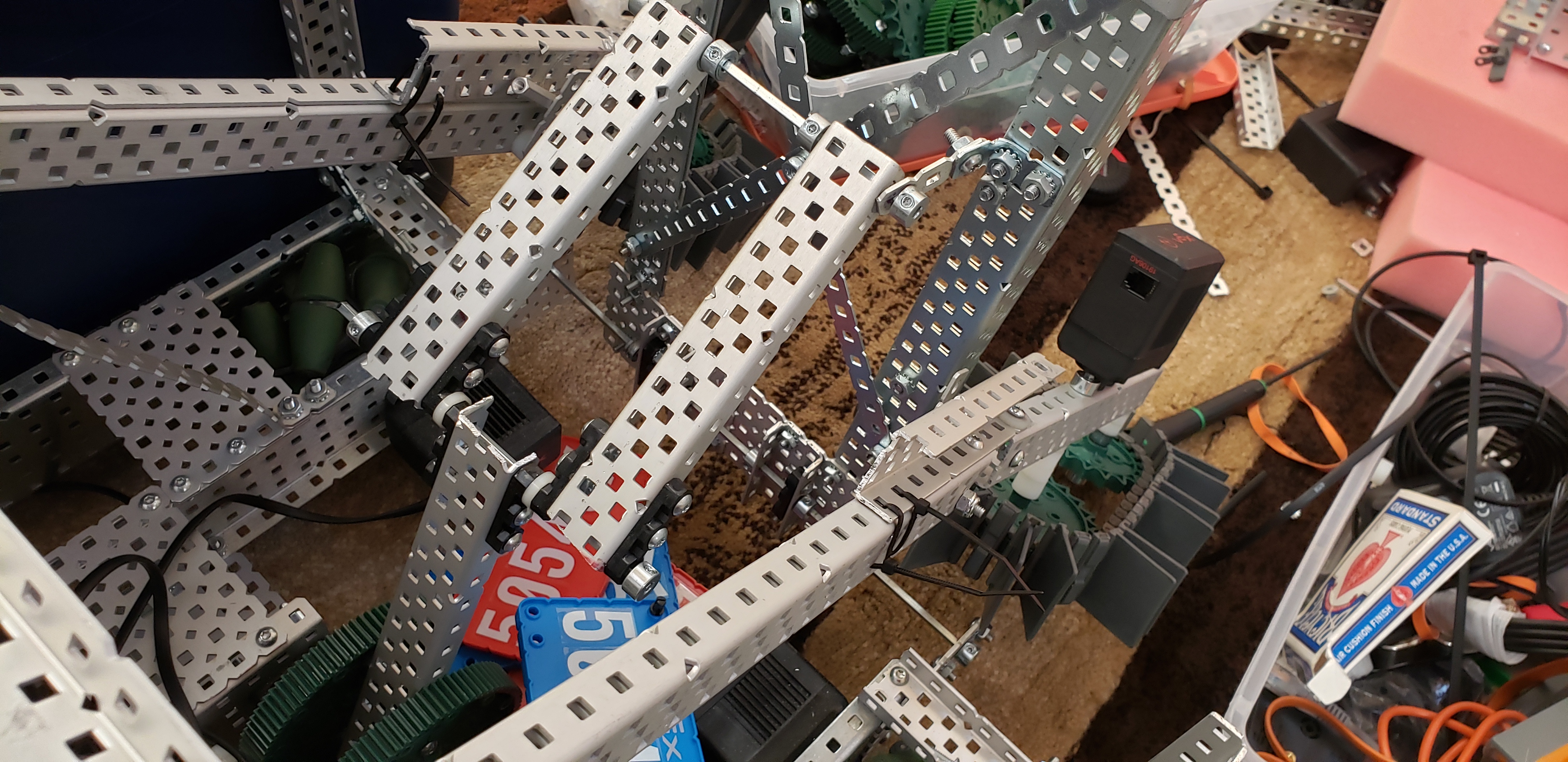

Directly proportional to the tray, what angle should the tiller be at?} With my tilter I’ve had trouble mounting it that it doesn’t interfere with the tray, but when I make a vertical flip out the intake rollers start interfering with the arm itself. Is there any which I can do other than changing the placement of my arm?
I would have a c-channel mounted to gears, attached to 2 more c-channels on a joint, connected to the tray on a joint. I dont currently have pictures, sorry. If you could provide pictures of your flipout for the rollers that would be great, also, if your tray is at an angle that is hard to push cubes up, you might want to adjust that. Also, make your tilter behind the tray. Im no expert, but I think think might help. I don’t quite know what you’re dealing with, so again, pictures would be great. Hope this helps!
Here’s a pic

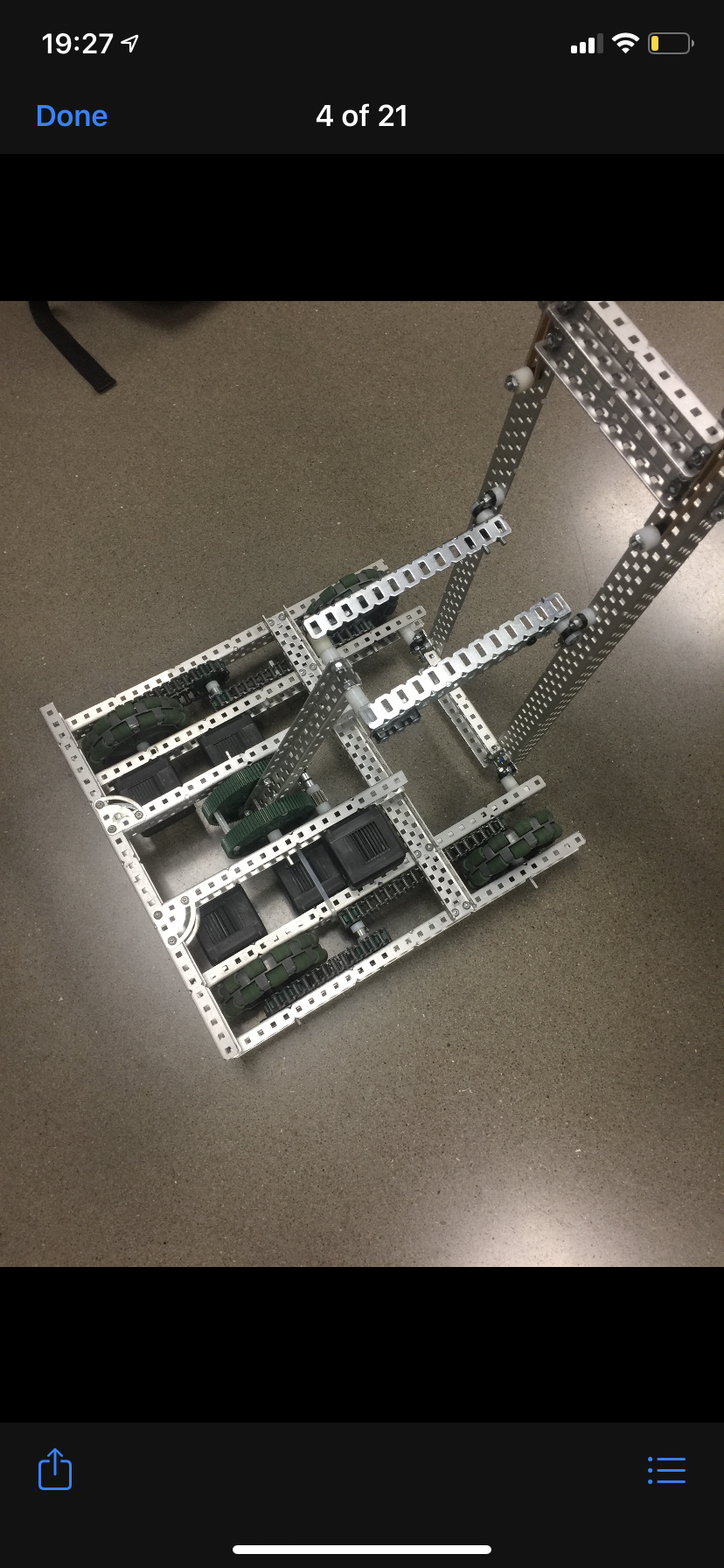

I believe this and what @33691A-Gold_Dusk have works for about every robot:20190930_171715
My tilter is always at the same angle as the tray and the part of the tilter that pushes the backing of the tray is always level with the ground. I intentionally cadded it to have this property so I can easily model the tray’s angle mathematically.

I don’t really want to show my hard work just so you can get an easy fix. But I designed it by setting the tilter and tray angle to 45 degrees and building around that. Make sure you mount the tray so you know everything will line up. Also note, the only way my exact setup would work would require you to hole count hole for hole because getting the tilter to rest exactly at 45 degrees for my particular configuration can only be done with the exact sizing I have. I hope that sort of made sense.
if you want your tray velocity to be constant, then you’d use a perfectly parallel 4 bar.
if you want to get ideal torque, then you want the maximum tilt of the tray to be perpendicular to the ground. most bots seem to have something in between.
